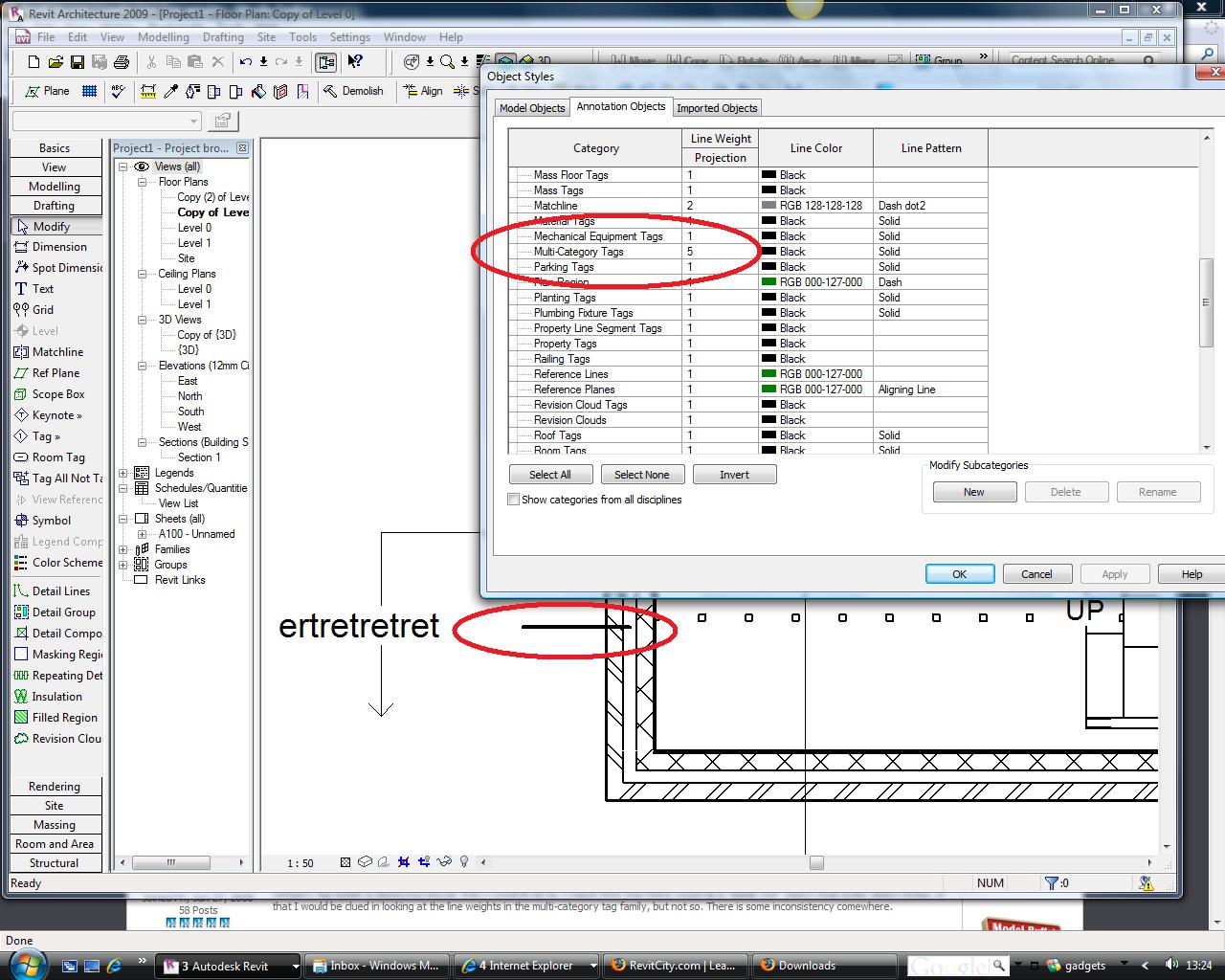

I am having difficulty getting my leader lines to dosplay correctly. One extends form text, and the other extends from a multi-category tag. The multi category tag leader is displaying heavier than I would lik eit to. I would think that there would be a "leader line" object style under object styles, or that I would be clued in looking at the line weights in the multi-category tag family, but not so. There is some inconsistency comewhere.
See attached multi-category tag andimage showing the problem. I'm using R-ARC 2009.

Go to object styles and look for multi category tags.  You can adjust the leader lineweight there.

A ha! thanks!
