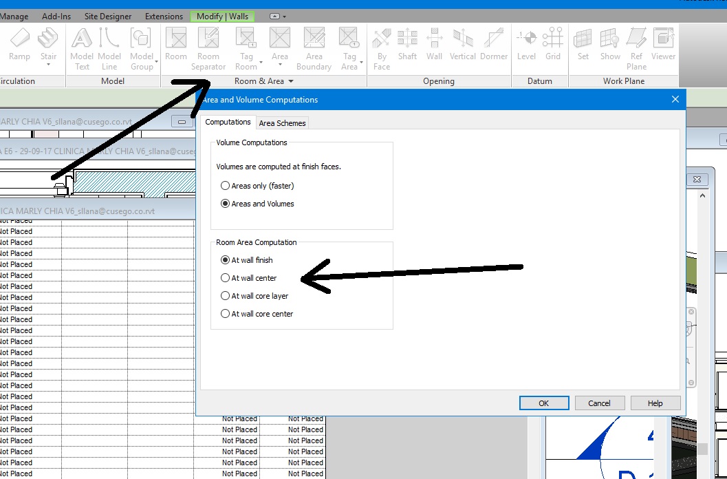

Thu, Oct 12, 2017 at 3:17:41 PM | Editing a room tag
sllana
Joined: Wed, Mar 2, 2011
106 Posts
5 Stars: 2 Votes
IN CASE THIS IS WHAT YOU ARE TALKING ABOUT
URL parameter in a room tag
