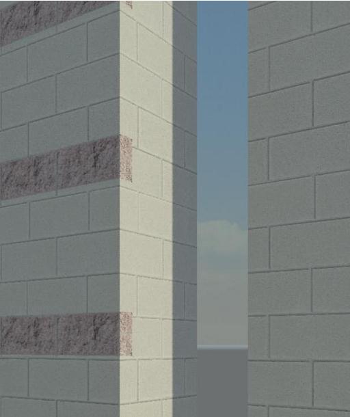

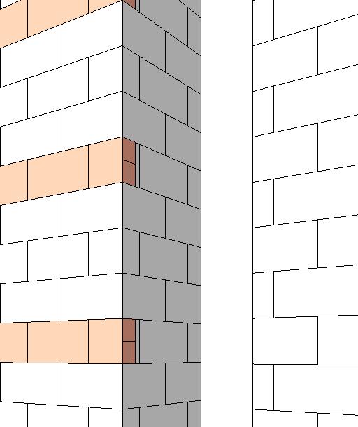

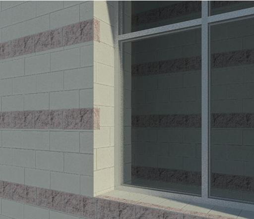

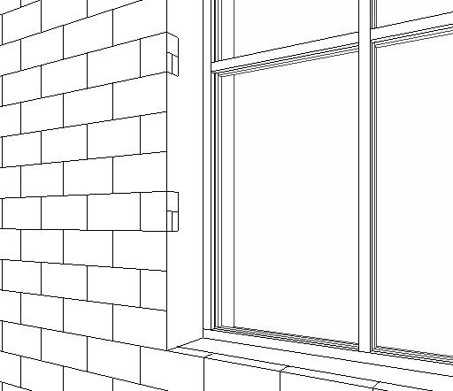

The Veneer return does not show at the embeded curtainwall:-the return does not show in hidden line rendering, it shows in rendering, but joints jump and the accent bands (wall sweeps) are off  - see View 2 (3D & Rendering)Is there any way to correct this?

Yes__
You might want to create an In-Place Family, to solve the return issues__
*it is often the case where the Wall's "Surface Pattern" will not match the Material Map, which may be why your sweeps are off...
A more detailed Surface pattern that shows the mortar thickness may help, you also can slightly move the Surface Pattern to mimic the Material Map.
