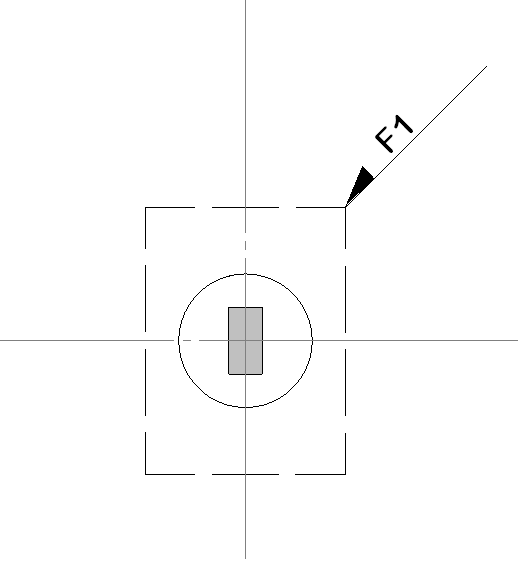

I am trying to create a Footing Tag that once iserted it places it self on the top right hand corner of the footing. How can I set-up a Family so that it always does this no matter the size of the footing?

Not possible. If you have a bunch that are the same you can adjust the tag to fit those and then just move the others.
