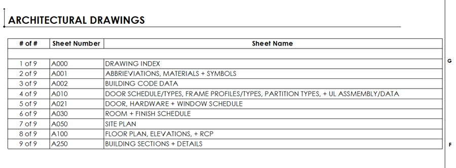

T O|D O Create a Drawing Sheet Project Parameter (Instance of Course)
  1. Settings > Project Parameters... > Add... > Name # of #_Common_Text_choose the desired Group_Instance_select Category 'Drawing Sheet'__OK
  2. Navigate to the 'Drawing List' (to create one > View_New...Drawing List...) > Enter into its View Properties > Fields<Edit...>_add the # of # parameter__OK
  3. Fill in the cells while in'Edit Schedule' mode
<3 and <3
