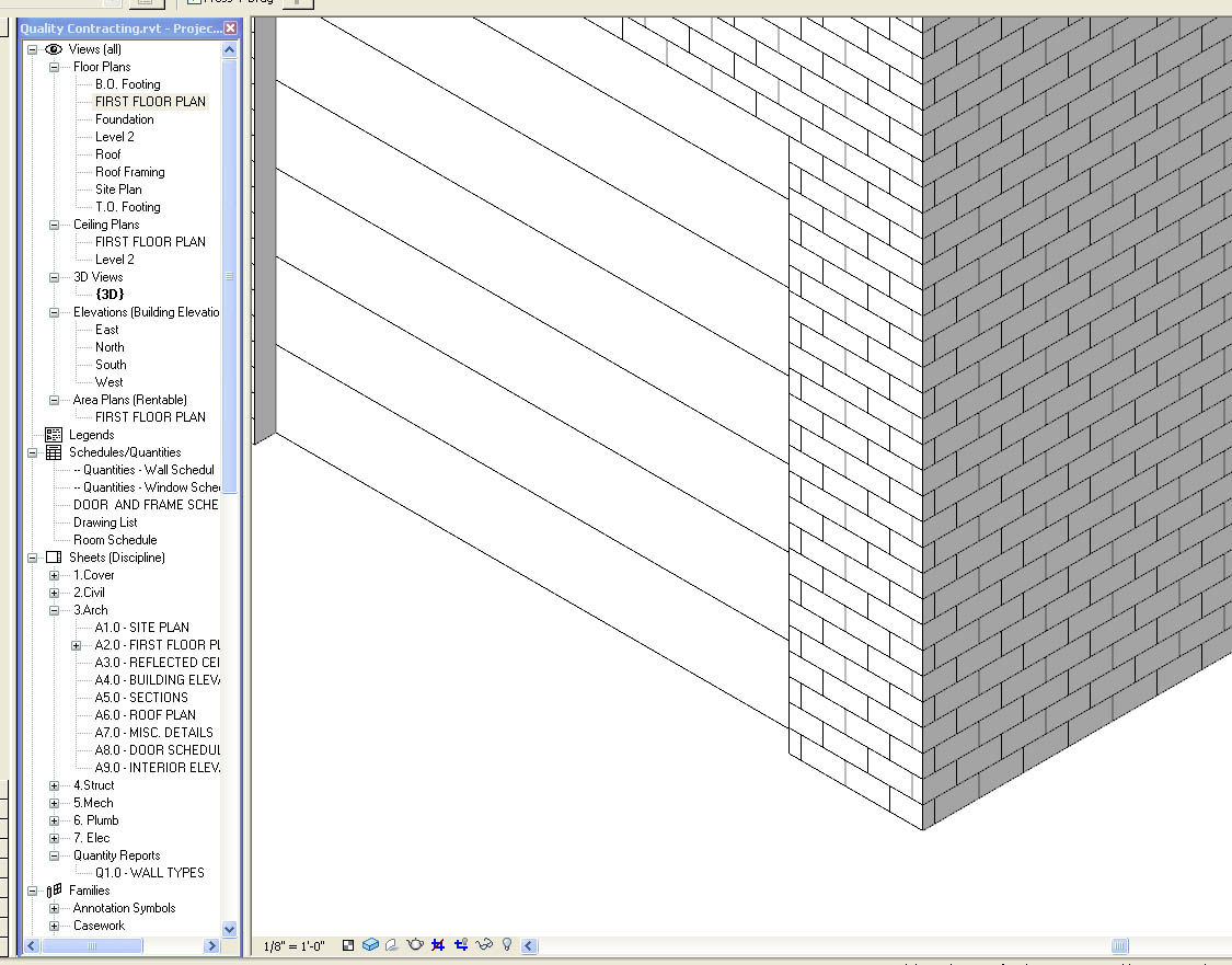

When I am creating a CMU wall the hatch pattern does not line up witht he end or beginning of the wall. It looks like it centers the pattern in the wall. Is there a way to assign the origin point for a hatch pattern so that it will course out?

See the first link below.
Fri, Jan 30, 2009 at 2:36:03 PM | CMU Hatch Patern
If you assigned a model hatch to the wall, you can just tab over a cousing line to select it and move - rotate it at will....no origins here...
Fri, Jan 30, 2009 at 2:43:43 PM | CMU Hatch Patern
davbrink
Joined: Mon, Dec 1, 2008
43 Posts
4 Stars: 1 Votes
Thanks
Sat, Jan 31, 2009 at 4:00:05 AM | CMU Hatch Patern
Joined: Tue, May 22, 2007
5921 Posts
4 Stars: 205 Votes
Also use the "Align" command.....
