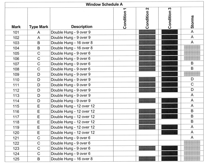

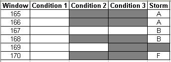

I too am searching for a way to add shading or fills to schedule fields.
For example, in a window schedule, I am scheduling 3 different levels of treatment based on existing conditions.  All windows require treatment 1 (leave the field open/white), certain windows require treatment 2, and fewer require treatment 3.  The idea is to black out the fileds in the treatment 2 and 3 column for the windows that don't require said treatment.  This way, I create a checklist for the workers and I'd rather not type XXXXX or NA.  I'd really like to black it out, or use some other hatch/fill.
Any ideas?  (See attached.)

I just experimented with using some of the "goofy" characters from the character map (Windows: Start --> Programs --> Accessories --> System Tools --> Character Map).
In the Arial font chart, I found the following:
U2588 Full Block
U2593 Dark Shade
U2592 Medium Shade
U2591 Light Shade
These are rectangular characters that can be copied and pasted.  The various degrees of shading come from varying point density in the rectangle.
I just entered six blocks in a row, (such as XXXXXX).  Once entered for one window, the drop down box makes it easy to select for the other windows.
See attached.

I asked Autodesk about this today and found out something interesting:
"You can use conditional formatting to modify the background color of specific fields in a schedule. To access the conditional formatting dialog, open the Formatting tab of the Schedule Properties, and press Alt + N, this should bring up the Conditional Formatting dialog"
Experimenting with this was fun, but didn't product the kind of results that JWILD is after.  The conditional formatting will only show up in the schedule view.  It doesn't translate to a plottable state on sheets.
