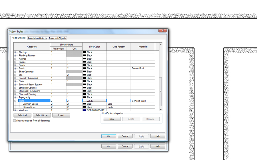

YES__
Got it!
  1. Navigate to the "Visibility Graphics" [VG]
  2. Click the "Object Styles" button towards the bottom of the VG window.
  3. In the Object Styles window, drop down the 'Walls' Category/
  4. Change the"Walls_Line Color" to White.
VIOLA Smile
*please find attached...where the effect has been Applied
