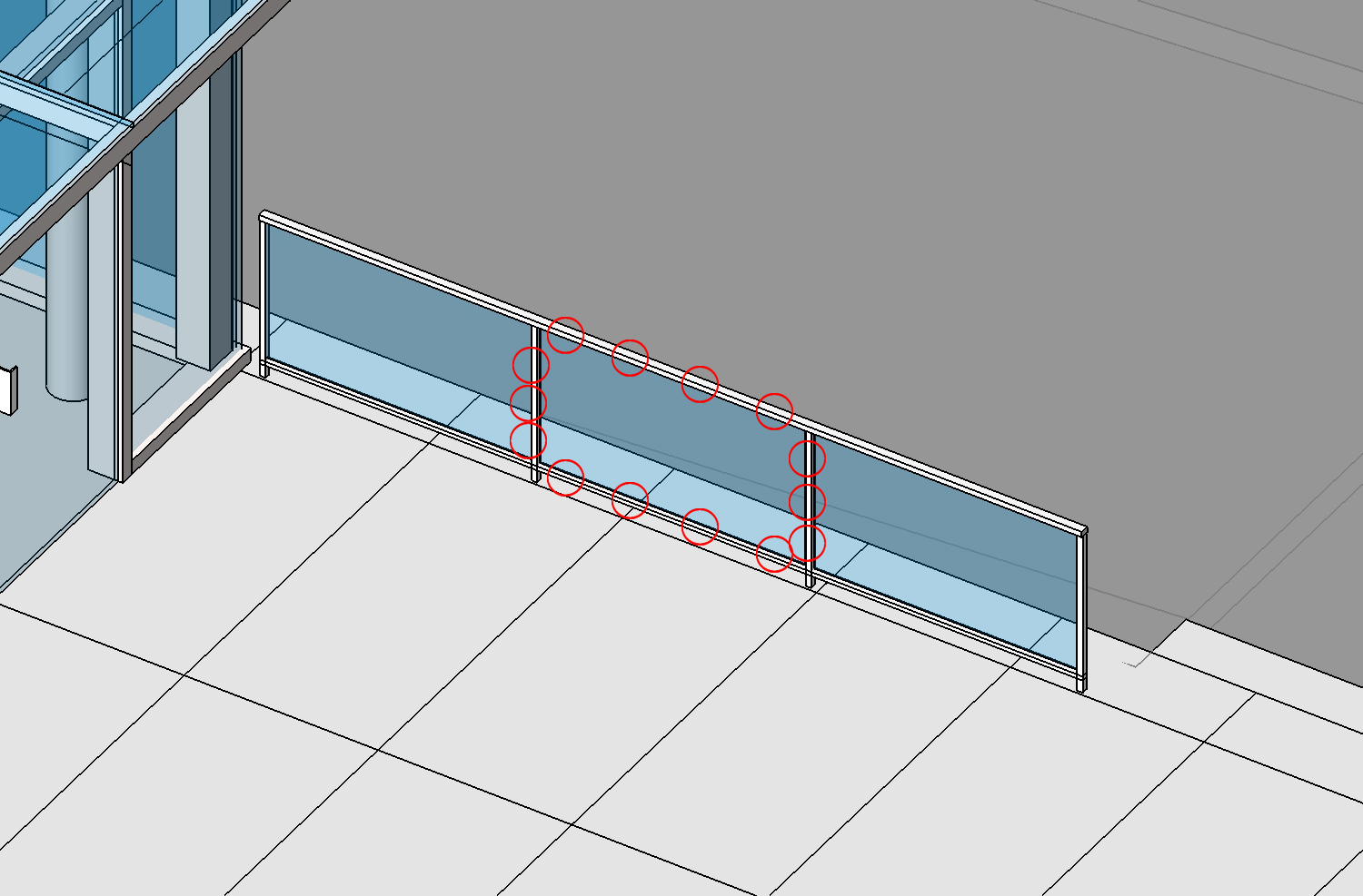

Thanks for all of your imput.  I did lots of trial and error to figure this out.  I ended up creating new profile families for the top and bottom rails.  I also created new families for the metal baluster and the glass panel (actually a simple baluster, not a boluster panel).  My last question is in regards to clamps that will hold the glass panel in place.  I want to use a simple metal and rubber clamp about 12" o.c.  Should I: a) model one as a mass, copy it into the proper places, and then group all of them with the handrail? or b) create the glass as a baluster panel which includes these clamps (this would make sure that the clamps don't get lost if the handrail gets moved)?
 Image included below.
Glass handrail
