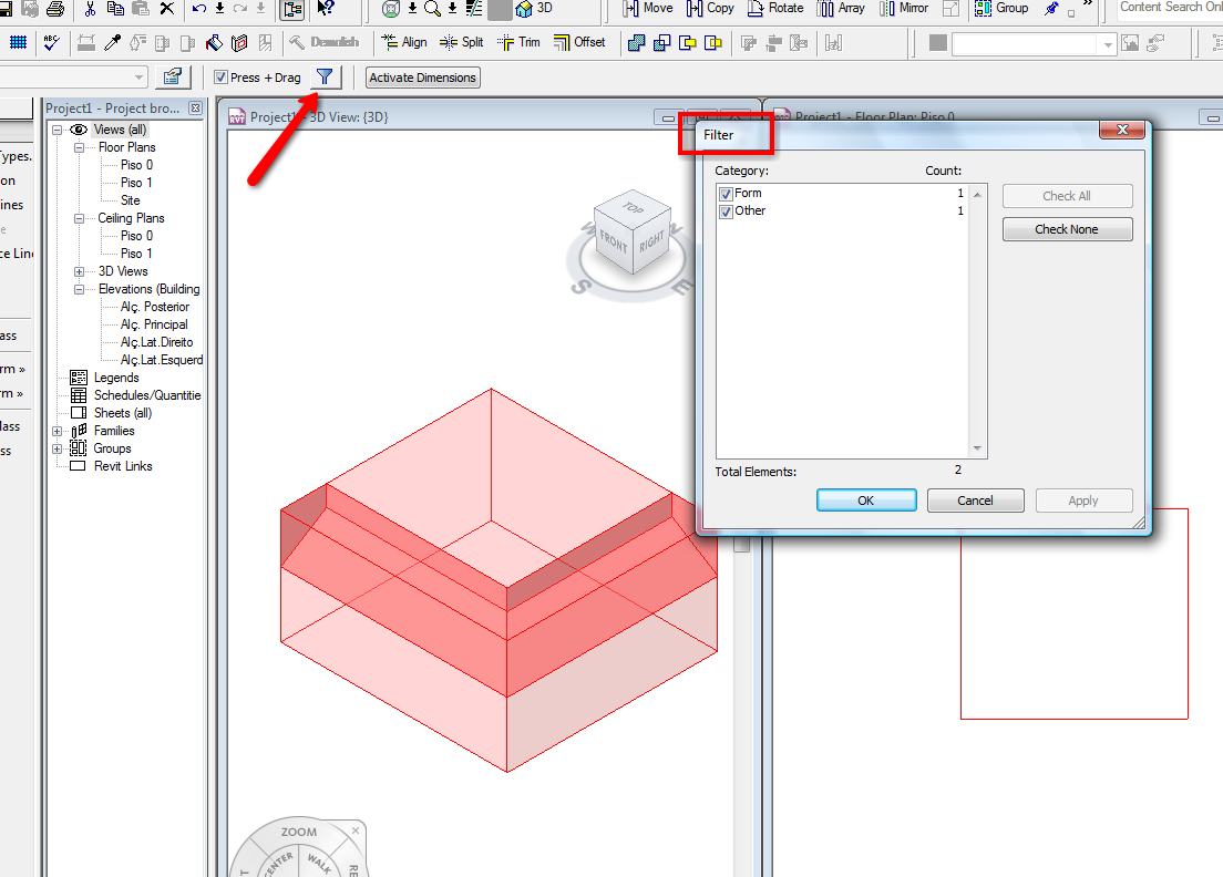

When I create a void sweep and the cut geometry, i then finish the mass. That void 'orange' void sweep disappears and doesn't show up with masses on. How can I easily find that void sweep to selct it and edit it. It sometime takes me several views and several minutes to find it. Is ther an easy way?

In the "mass family" or "In Place" you can use the "Crossing selection" and go to the filter like in the image attached OR you also can use the "TAB" key "when you go with the mouse to the objects) to alternate the object tyou want to select....
