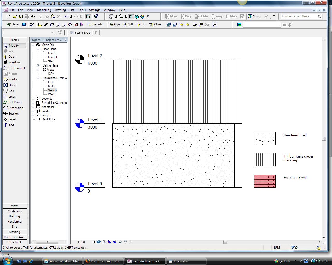

You can do this with family members such as windows by dragging them from the families in the project browser into a legend view.  One way that you could work around to get a legend for walls is to create small sections of wall showing the different finishes and hide them in views or place them outside the crop boundaries.  If this is a problem, export the view and import it into a drafting view and erase the walls from the actual project - see image.
