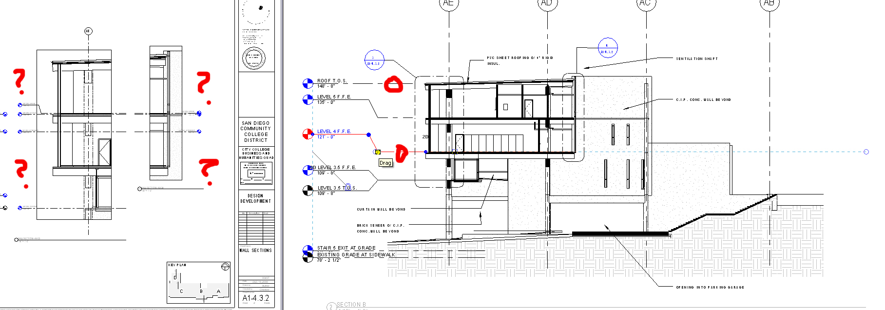

So, I have my level lines visible in a 1/8" building section. The open circles / 3D extent are well within the clipping range for a wall section that I call out. I call out the wall section, open the wall section, and random level lines are nowhere to be seen. They are not hidden, I see a couple, but some are missing. This strikes me as being random. I have spent way too much time tinkering and thought I'd send it out to ya'all. What do you think?

Here's an image describing what's going on. The wall section is on the left and the building section is on the right. Two levels are clearly missing.

Simple answer. I was limiting my search to one plane. The extent of the level (read "open circle"Winking was moved outside of the view. Why it shows up on the  building section and not the wall section is beyond me. In any case, the level was not set uyp right, or rather was moved by someone who did not understand how levels are set up.
