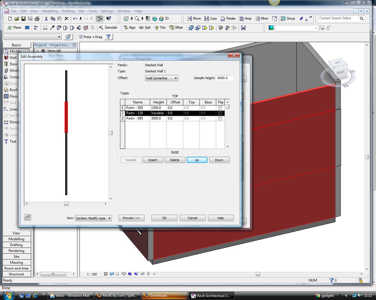

This has been driving me nuts all afternoon.  I am trying to build a vertically compound wall with several split regions.  I want it to grow in the middle if the wall is changed height. IE a brick wainscot at the bottom and a Stucco cornice on the top.
 So the problem is once I create a split on the bottom at 4' it will not let me measure from the top down it wants to measure from the last split. If I do that then the cornice grows instead of the wall in between the two. How do you get it to make the offset from a different point than the last split

Are you using the stacked wall feature in Revit?  You need to insert the variable part which can be moved up or down in the middle - see image.

No I was not I was trying to split components of a regular wall. This works much better. Thanks
