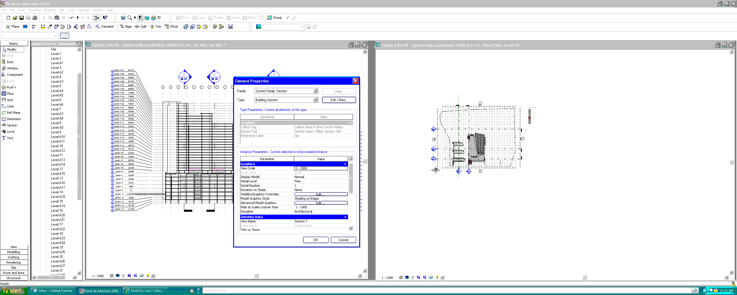

I need to add colour fills on my building sections (the colours must match the room-colours I have assigned to the rooms on plan already), and this seems impossible. Can it be done? I've already added room tags on my sections, but Revit doesn't allow me to add a colour-scheme and colour to the sections...

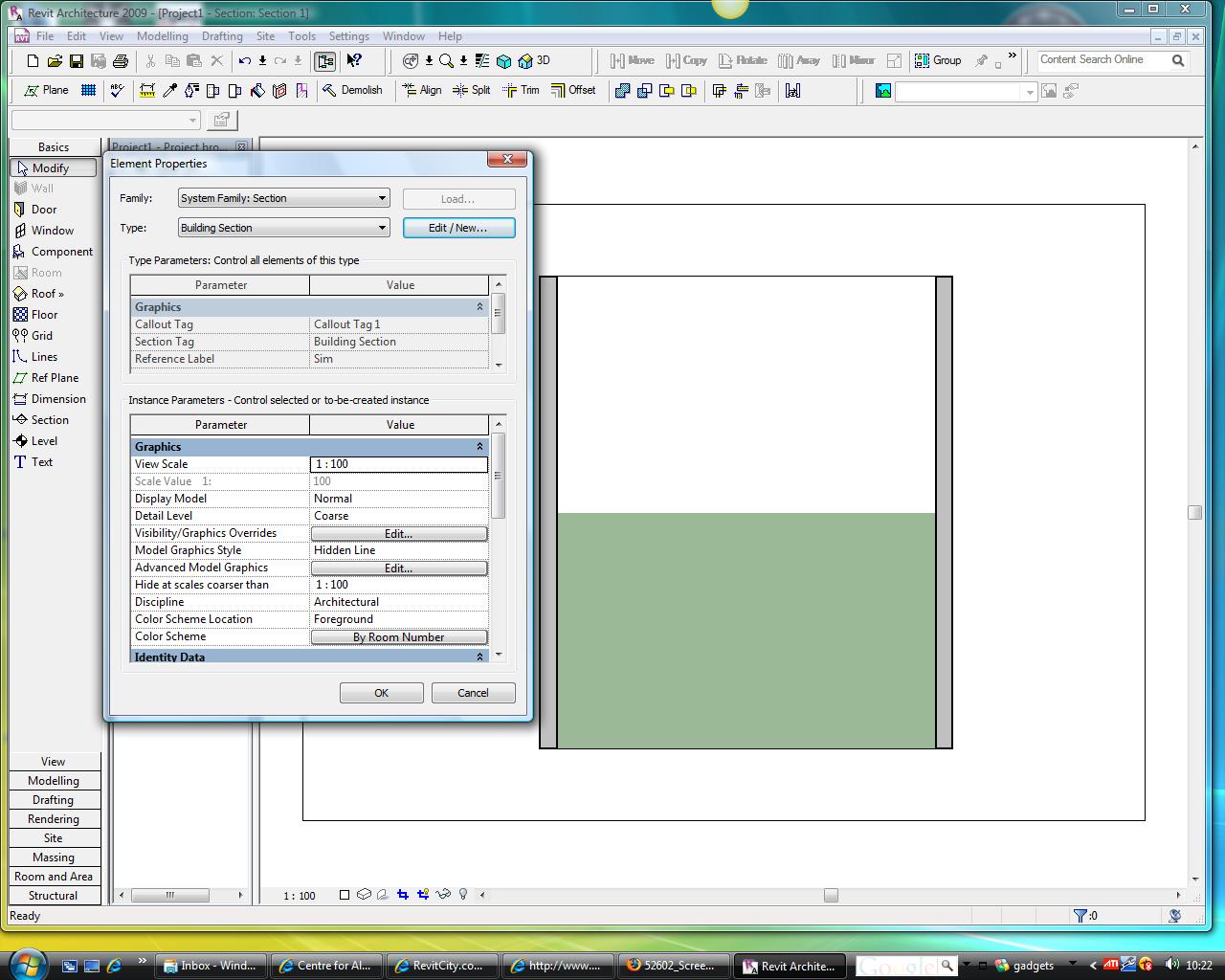

Go to the section view properties and set in a colour scheme.  Set the colour scheme location to foreground.

Thanks tim123, but no-can-do. The Section View Properties box doesn't have a "Colour scheme" tab. Only the the floor-plans view-properties have it... Any other advice?

OK, you can't with 2008.  You need Revit 2009 for this.
