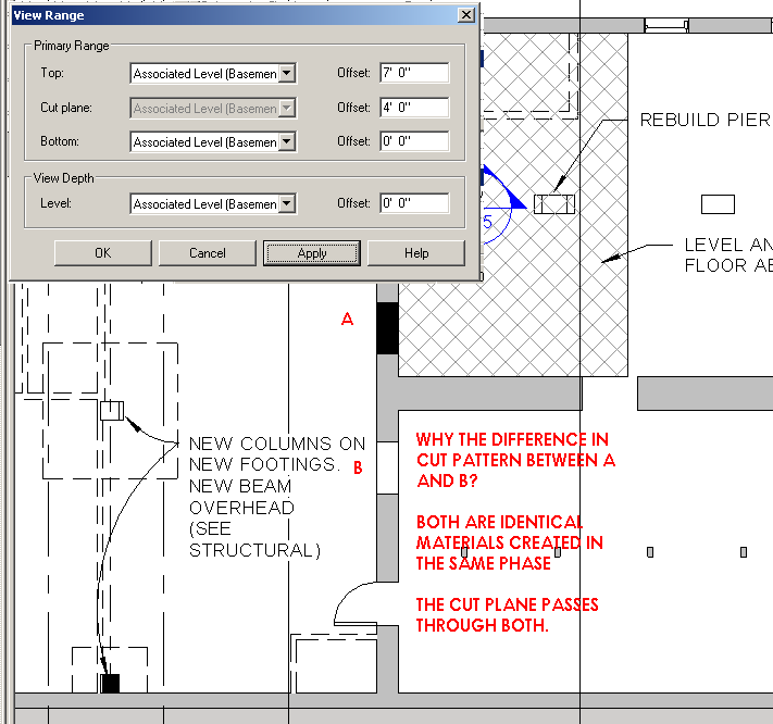

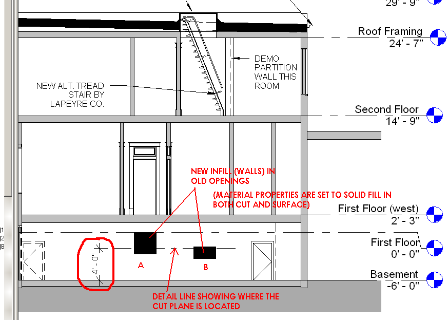

The attached images show a common problem I have with VIEW RANGE.  Two similar elements are cut by the cut plane, yet they display differently.  I don't understand why.  Both elements are of the same material.  The material is set to have solid fill (black) for both the surface and cut pattern.
Version: Revit Architecture 2008
Interestingly, infill element "B" will display with the proper solid fill (black) cut pattern when "Bottom" and "Level" are changed to "Unlimited".  It seems like the logical thing here would be that if the cut plane is set to pass through the element, it should display with the proper cut pattern.

Probably it happens, because of your primary range Top, tries to show the wall above the infill....
