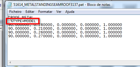

I looked at these two files as text and they are really very simple model hatches.  You should not be having any problems.  Something else is wrong.  Maybe ther is something embedded that I can't see in these.  If you think that's it, just open a notepad window and type what you see when you print these.  Don't use copy/clip if you think something might be embedded ... although I don't think it can be in a simple txt file.

So I keep trying to import pat files for a standing seam roof.  I have gotten two patterns from RevitCity and it keeps telling me no drafting pattern or corrupt pattern.  I have attached the two patterns can anyone see if they can get it to work?  I am working with RAC 2008 and I can get other pattern files to work but not these that I need.
Thanks in advance,

These Pat files are "Model" not "Drafting"... delete the line and save with other name and you have two pat files, one by Model, other to Drafting...

Thanks for all the post.  Thyphoon thanks new it had to be something simple like that.  Something simple I just did not know.  I learn something new every day most of the time from all of you.

i'm confused now, shouldn't you be able to use both types of .pat files (Model and Drafting) in Revit?

Yes but I kept trying to import it as a drafting and not model.
