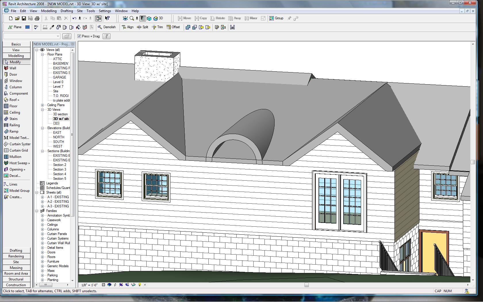

Hello All,
This is my first post, great site. This is our first revit projec at work, first for myself as well.
 Anyway I am having trouble vuting an opening for an evebrow dormer. Am I doing something wrong, I have tried everything I can think of, now I humble ask for some guidance...
 Please see the attached image.
 The roof in which I am trying was created through "roof by footprint" and the round dormer was created through "roof by extrusion" all done in Revit Architecture 2008
 thanks for your help

Hi, use "Modeling>Opening>Vertical Opening"....

Typhoon,
 Thank you!  it seems I tried everything but that.
I really appreciate it, best of luck....
