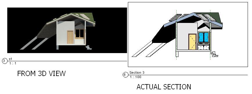

hey typoon, thanks alot, now i know how to render elevation, im just having hard time getting the right scale, after rendering the elevation, i put in to the sheet i made, and campare it to elevation view(shading with edges), sometimes theyr not the same, why is that? same in section rendering..thank you very much in advance,good day

Like what??? can you put some images to check???

here it is typhoon, elevations are in scale but not the section, thnks in advance

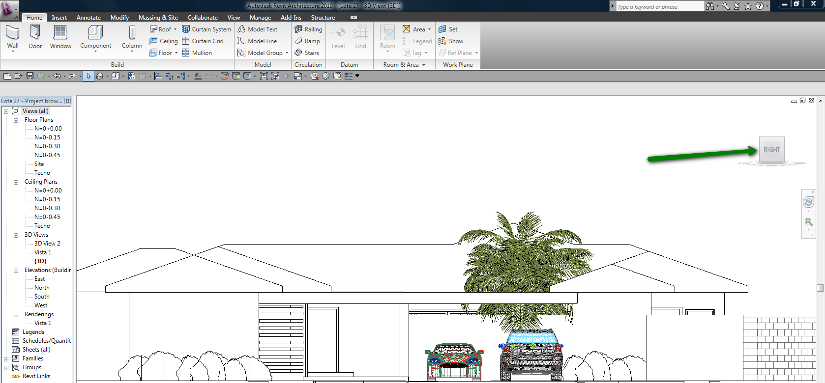

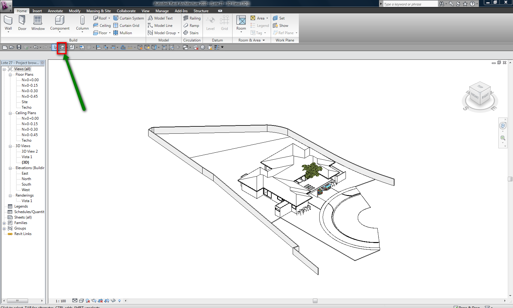

before using camera tool just unclick perspective in top menu, next to scale, it is only thing you have to do and then just render your elevation

Just create a 3D View and then click on the side of the cube you want to render......
