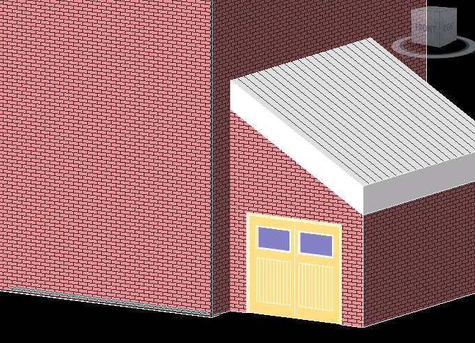

Guys, oddly enough, when I did my model again and added my roof, the brickwork that I wanted filled was automatcally added for me. Earlier on for some reason it was omitted.
Anyway, just in case you were curious I have attached a test screenshot of what I was ranting on about. It is the brickwork between the top of the slope and the head of the garage door that I was trying to achieve but it seems fine now.

Ohh, that's was because Revit ask you if you want the walls attached to the roof, so next time to solve that pick in the walls and in the option bar pick in attach, then you have top and bottom, select top and pick in the roof....
