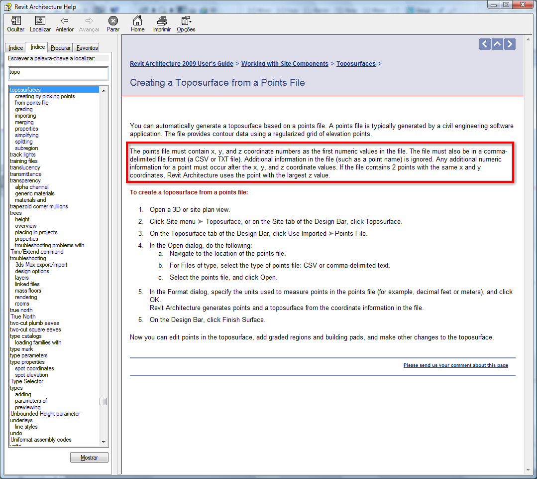

SO HERES THE DEAL I AM TRYING TO GET MY TERRAIN INTO THE DRAWING BUT FOR THE LIFE OF ME i CANNOT IMPORT IT. i HAVE THE DWG IT HAS "Z" AXIS VALUES. SO I CALLED THE SURVEYOR AND ASKED FOR IT IN CSV FORMAT AND DXF FORMAT. CAN SOME ONE SEE IF I'M MISSING SOMETHING OR IS IT THE FILE. BTW I AM RUNNING RAC 2009

Your DXF file is Corrupted, try to create a new one, about CSV file see this by the HELP menu....

THANK YOU FOR YOUR QUICK RESPONSE TYPHOON. I HAVE BEEN RACKING MY BRAIN FOR 2 DAYS. i READ THAT FILE AND EVEN TRIED MODIFYING THE CSV FILE WITH DO LUCK. THIS IS THE FIRST TIME I HAVE TRIED IMPORTING  A SURFACE. i HAVE FOLLOWED MANY OF YOUR POSTS AND FIND YOU TO BE VERY KNOLEDGEABLE IN REVIT i HAVE ATTACHED THE DWG MAYBE THE PROBLEM LIES IN THERE?

Hi, see this: http://screencast.com/t/UgZ11JfM

i FOUND MY PROBLEM IT i HAD THE THIS VIEW ONLY BOX CHECK. IT WAS NOT ALLOWING ME THO SLECT THE FILE. THANKS SO MUCH TYPHOON. YOU TRULY ARE A REVIT GURU LET ME KNOW IF i CAN RETURN THE FAVOUR
