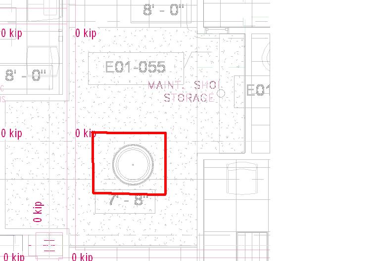

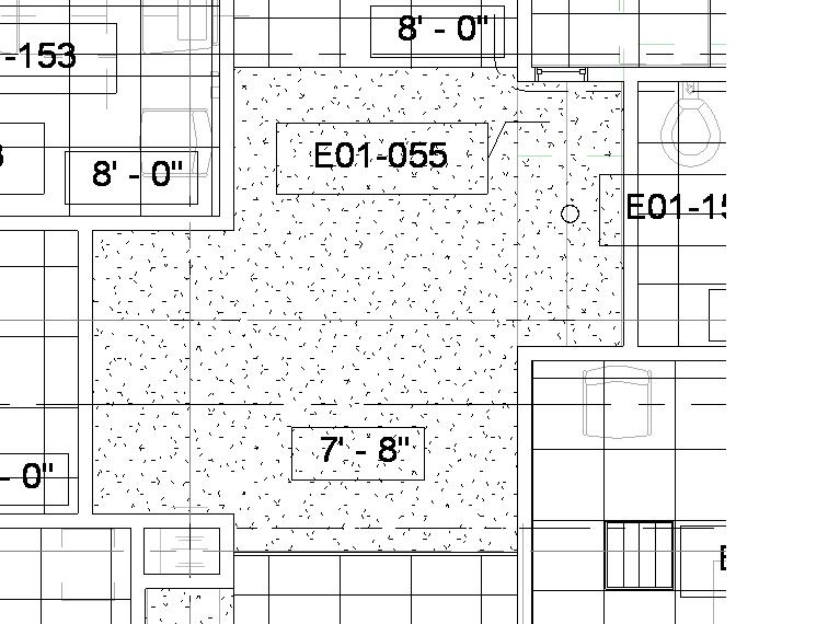

I have a lighting fixture that will not display in the RCP.  I've been able to cut a section through it and see it in section.  Also, when I turn on "Reveal Hidden Elements" I can see it even though it's not actually hidden (I've attached screenshots).  Any assistance would be greatly appreciated.
 Thanks, Jim

Yes, the family should cut the ceiling.  The fixture works in another file without a problem.  I'm trying to do a comparison of the 2 files, but thought that someone on here may have an idea as to what to look for.

Got it...I needed to check Imports In Families in the Imported Categories tab.
