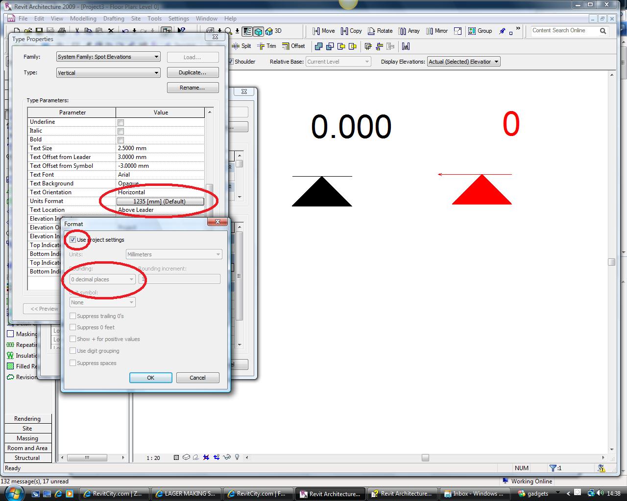

I set my project units to suppress 0 feet.  The problem is that in my levels, at the ground floor it just says 0" now.  I guess it's doing what it's supposed to do, but in this one area I want it to say 0'-0"  Any help?

Go to the levels properties and you can overide the format for that particular annotation (under 'units format').

If I understand your problem correctly, you have placed a level using the spot elevation tool, and in a particular view you would like to overide the number format.  If this is the case, go to its properties, duplicate the elevation symbol and overide the unit formatting - see image.

Ah, well that's the thing...it's not a spot elevation...it's actually a "level"
Fri, Jan 16, 2009 at 10:10:54 AM | Zero Suppression in Level elevations
I don't know a way to get rid of this because it reads the information as a real value that you set to 0.  You will have to use a level head that does not have this value.
