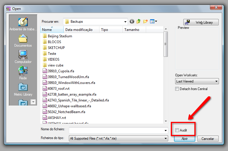

Hi, did you try to "AUDIT" the file??? did you try to "Import/Link" that same file into new project???

Hi, Duckitech, So,this means that you can't open your Revit now???? If it's so, the only way could be by reinstalling all again...and when done try what Typhoon says...audit your file before you open it again...

Hi Duckitech, I forgot to tell you that you've to install the web update#3 servicepack for Revit 2009 too. You can download it from this website: http://usa.autodesk.com/adsk/servlet/item?siteID=123112&id=11017599.
