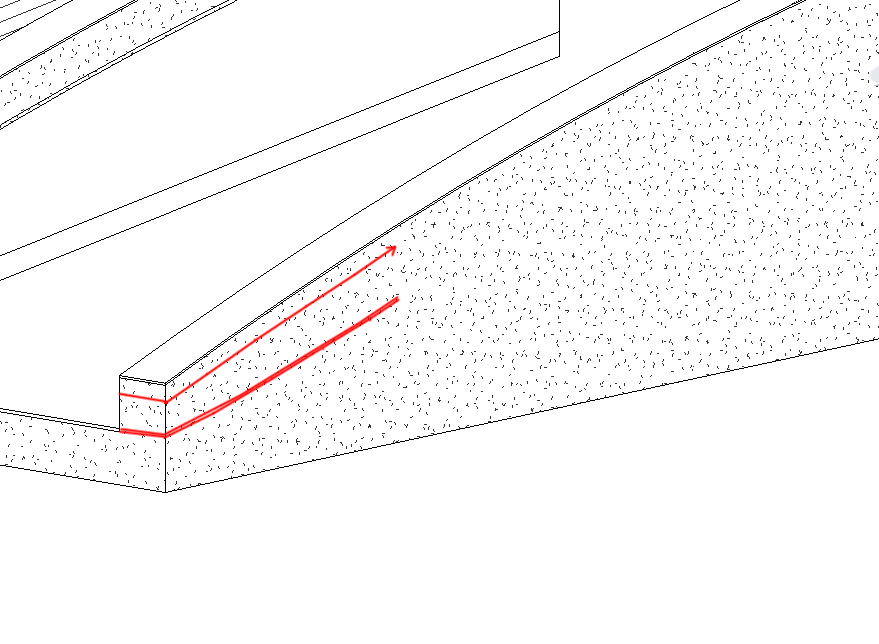

Im having trouble with this one. I used roof> roof by extrusion to create my curved roof as seen in attached picture. Then my plant-on wall is attached top to this roof. I need to create a flashing sweep (in red) around the edge of these curved roof, the host sweep does not seam to work. Is there a way to do this? i also need to create a reveal (in red) in the plant-on along the curved path of the roof.
Thanks for any help
James

Use the "Create-in-place" "Solid Sweep" and "Void Sweep" to create that, you can use the "Pick Path" to select the curve....

Thanks that was it!
