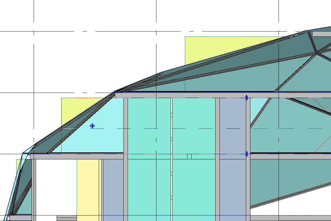

There is another question. You can see the picture. The yellow are is the room in section, but it isn't been limited in the building, it exploses one cornner. I have clicked room bounding in the curtain system wall. I can't change the curtain system wall to roof. Because the curtain is made by mass face, from bottm to the top.
What could I do next step?

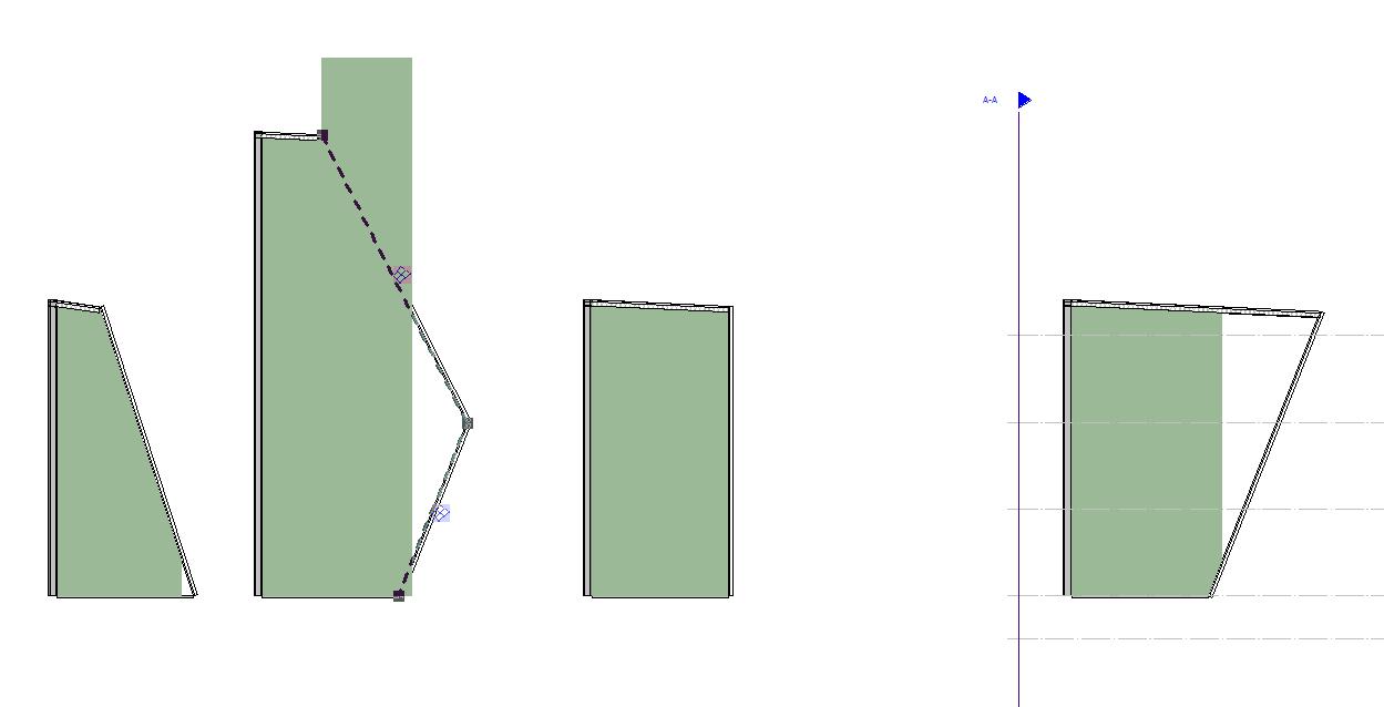

Frankly, I know how to add the color in the section. But in the pic, I do per your suggest from anothe thread, but the 2nd section is still not right. I have given the boundery to the curtain wall,but it doesn't work.  Also the first and the 4th ones are not what I want. I want it like the 3rd one, filling the color full of the room. Maybe this is a bug in Revit, but is there anyway to make up it?
Thank you.

Check that the unbounded height is higher than the top part of the roof.
