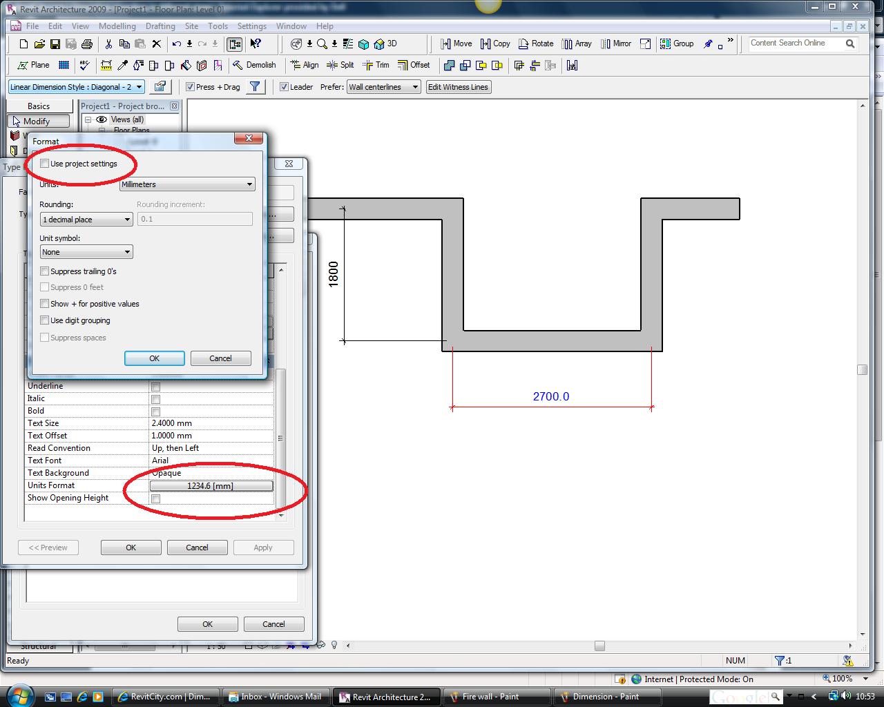

in my office we want to round our dimention to nearest 5mm on floor plans. (as much as i disagree with it i need to do it).
Which is easy enough by changing my 'project units'.
however this transfers through to elevations, details etc. which is a problem with window sill and head height and many other things im sure. is there a way to have different setting on different views.
... personally i would not round dims at all, but i work for someone who strongly disagrees ... any ideas?

Create a new dimension style.  Go to the element properties of the dim and duplicate it.  Go to Units Format and overide the project settings.
