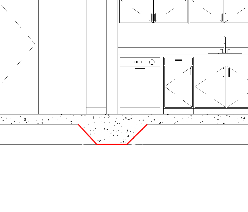

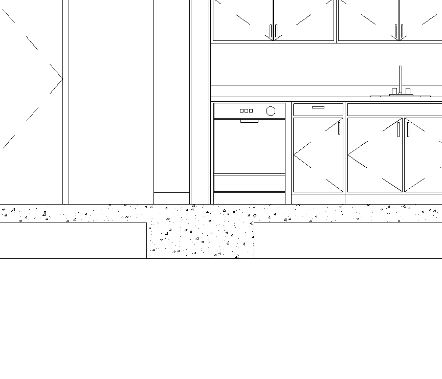

I tried looking for help under the search but just cant find what im looking for. Im adding a Bearing Footing under interior walls, using Foundation Wall, (Wall Foundation: Bearing Footing 36"x12" ) but it is rectangular. I need to have chamfered side as in red in my attached pictures. Is there a way to modify the pre-set shape,or a differant way of creating a footing for interior load bearing walls?

you might try voids to cut away the unwanted material. if you are not going to be caculating quanities and just want it to look correct in section you can try the edit cut profile tool.

You can create a new family using the structural foundation template.
