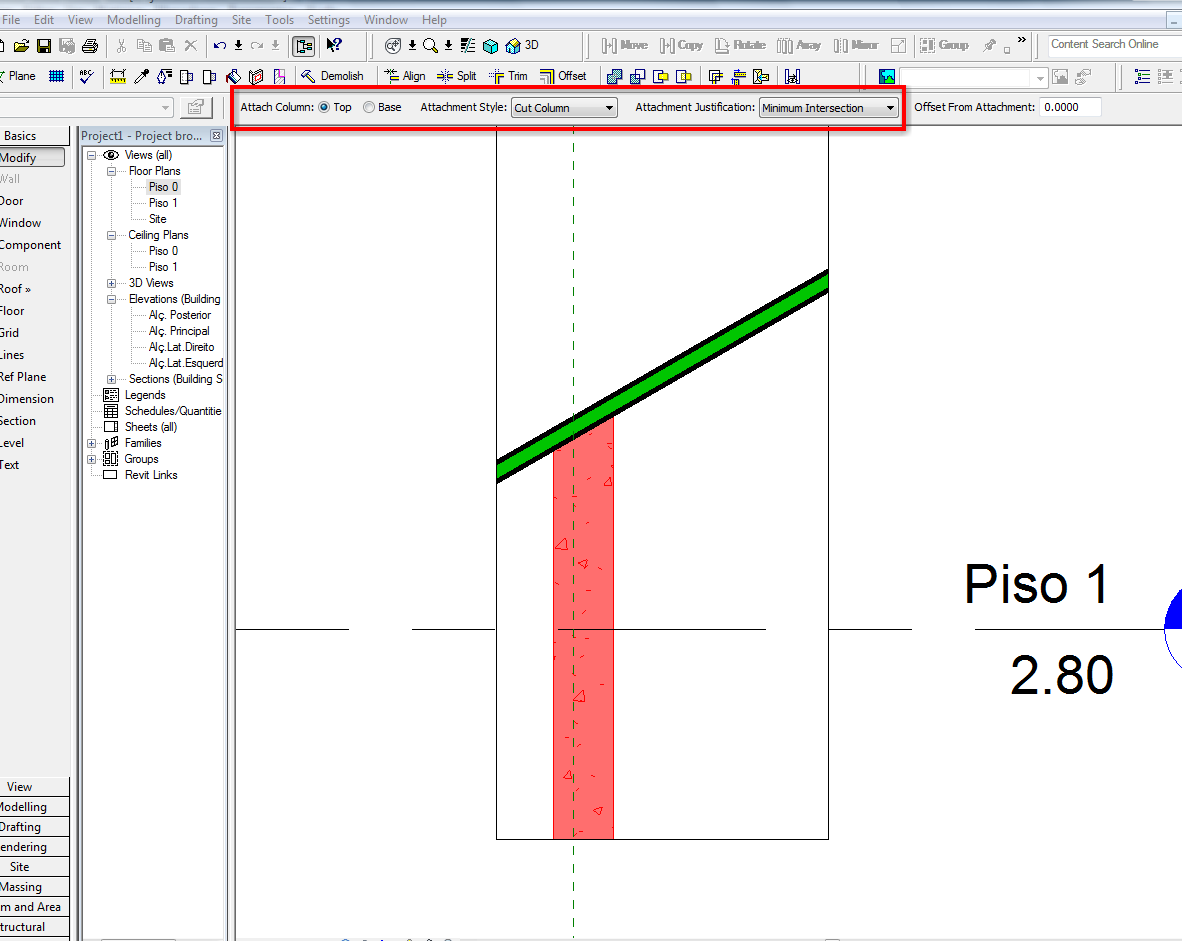

I have drawn a mono pitch roof, which is simple enough but now i wish to set the tope of the columns to the various points along the slope, is there a way to do this? I have do it b offsetting or cutting to the line but both seem like short cuts and quick fixes, im hoping someone knows a way of doing it that I dont!

Hi, pick in the columns and pick in "attach" and pick in the roof like you can see in the image below...
slope top of column
