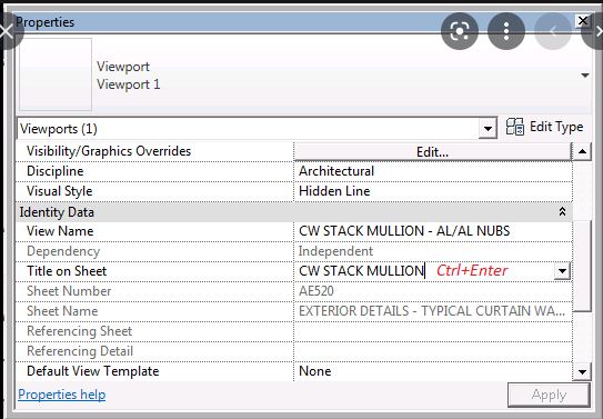

Is it possible to wrap the title text?
Wed, Mar 23, 2022 at 7:08:33 PM | Formatting Schedule Titles
They say this process still works: CTRL-Enter like see image

I tried that and get the following message.
Thu, Mar 24, 2022 at 2:06:02 PM | Formatting Schedule Titles
#10
You don't enter the plus sign

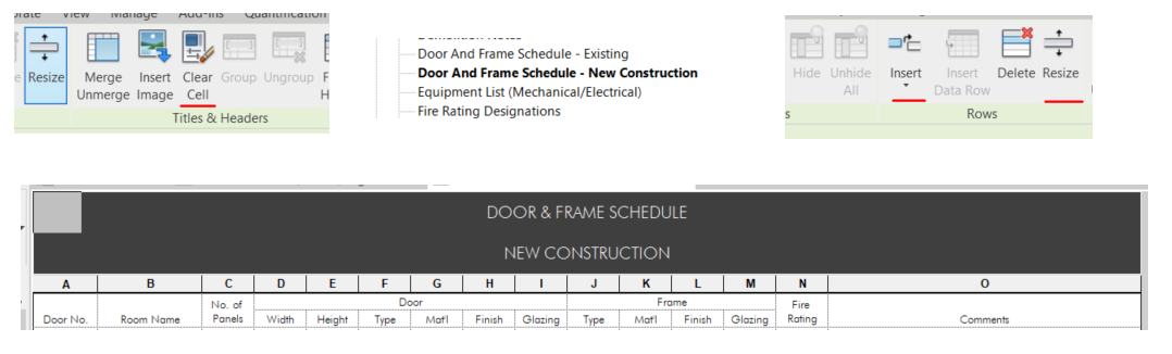

Here is an easy way to get two line titles for Schedules.
  1. When in the schedule click in the header.
  2. Then in the ribbon click clear cell (this allows you to have a different header title than what is shown in the project browser)
  3. Then type what you want for the first line.
  4. Next click insert in the rows section on the ribbon and add a row below.
  5. Then you can add what you want as the second line.
  6. after that you can remove the border between the two cells and resize them to adjust spacing
See picture for example.
