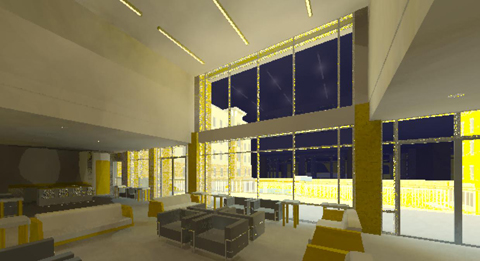

I've done 10+ drafts of this interior rendering, with every combination of sun on/off, interior lights on/off, daylight portals, light fixture color temperatures, and I keep getting a bizarre yellow finish on everything.  All the materials render fine in all the other views, and only a few of the objects in this view are turning yellow while other objects and materials look fine.  It's quite odd.....
Attached is an image file of the problem.
Thanks,
Kevin

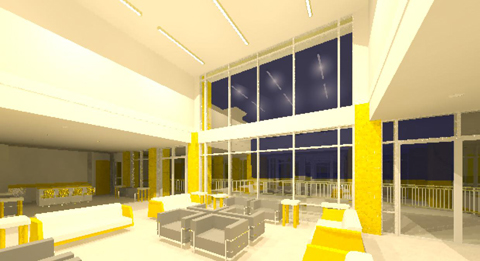

This just in: tweaking the "white point" in the "adjust exposure" settings fixes a lot of the yellow problem, but it turns a few smaller background objects a ghastly shade of blue.  But perhaps they can be hidden.

You have after the render the "Adjust Exposure" to control that too, try to use it...
