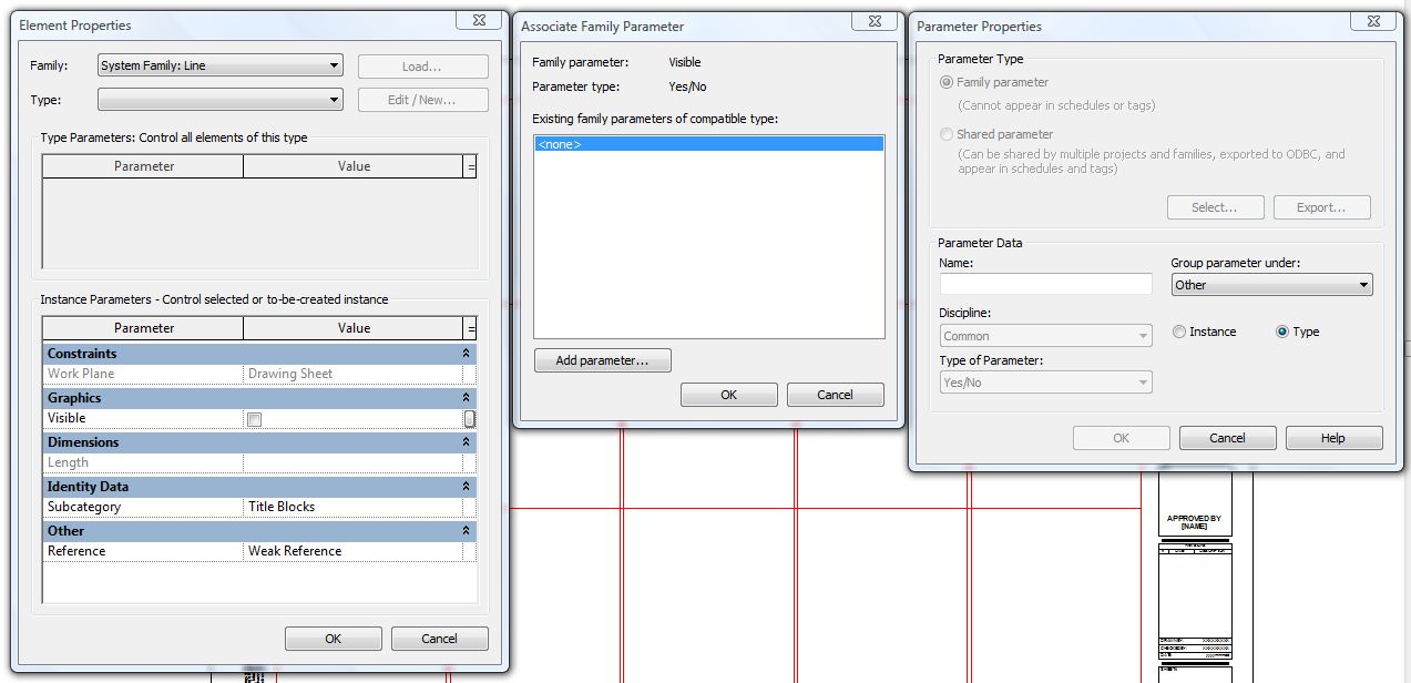

Hello all,
I'd like to add a grid to our titleblock, to be controlled by a visibility parameter. I had tried out this technique in a generic family and it worked great. Now that I'm trying to do the same in the titleblock family, I can't create the shared parameter I would need (option is grayed out).
How do I get this to work? It seemed so simple before, and now I'm not getting it done.
Are invisible lines another option?
Thanks!!!
Great Revit karma will come to you for answering my many questions.

You really shouldn't need a shared parameter for this as you use shared parameters mainly for scheduling or parameters that repeat themselves in multiple families like height, length, etc.
A family parameter will work for this w/ o having to add it to the project.

that's true, but I'd like to schedule it. Actually, I don't want to see the grid being printed, and scheduling the visibility would allow me to quickly check whether or not all sheets have the grid turned off. (I use a working schedule with all the information that's available on sheets).
I had tried out invisible lines, but those became invisible (seems logical) so they were of no use to me in lining up my detail views.
