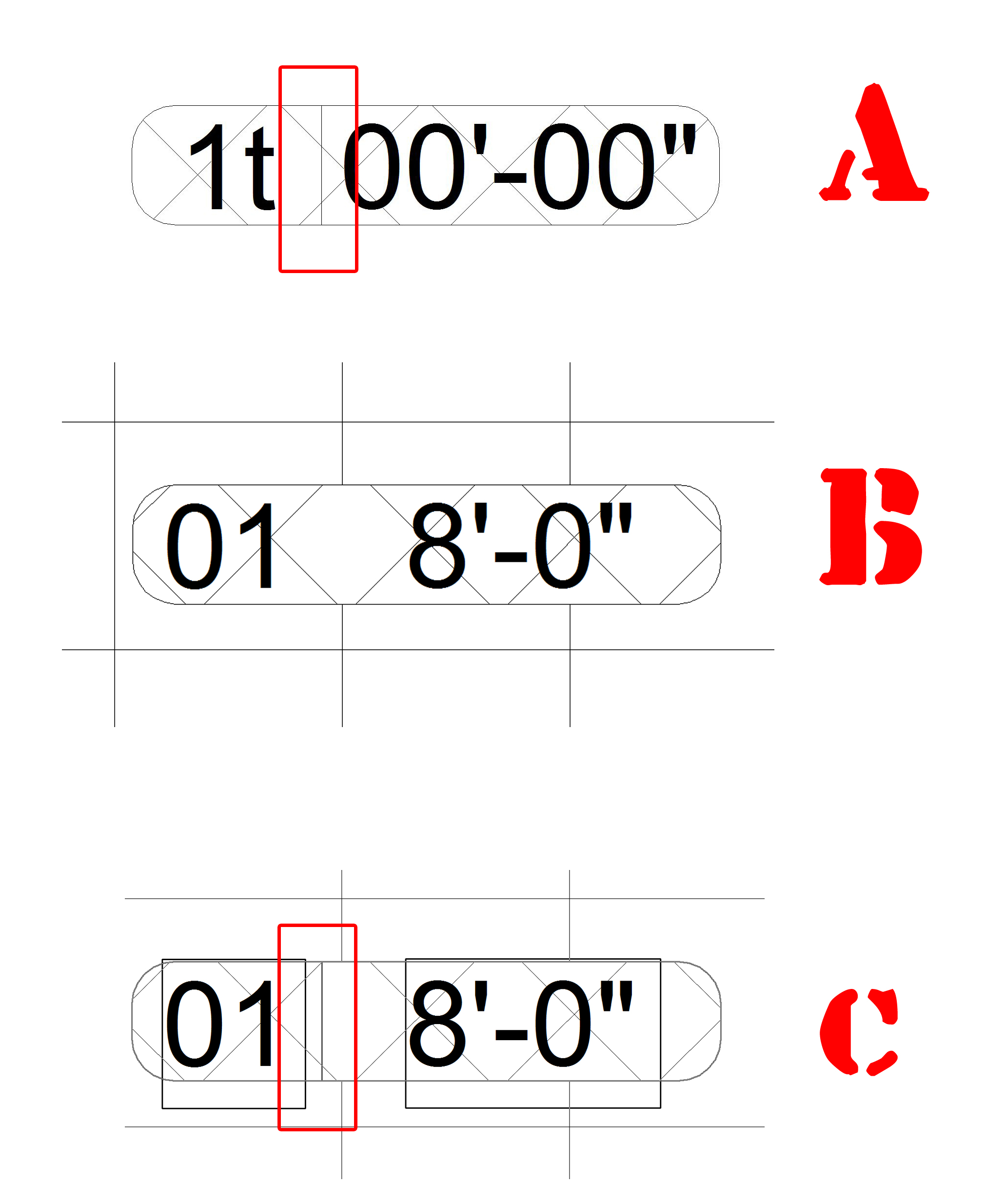

I created a Ceiling tag, displaying two labels (type and height) to be separated by a line (see A). Once I place the tag, I'd like it's background to be white so no ceiling hatch shows through it. This works with both a Masking Region as well as a Filled Region, but that line disappears (see B). However, when I hover on the tag, the line shows (see C).
How do I bring that line to the front? I've already tried drawing a new line on top of it, but I can't find an option to bring it to the foreground...
The crosshatch in the background is only to indicate the region.
Thanks for your help.

Just break the filled/masking region into two pieces where the line needs to occur

That was almost too easy. Smile
It worked great. Thanks a lot!!!!
Great Revit karma will come to you for answering my many questions.
