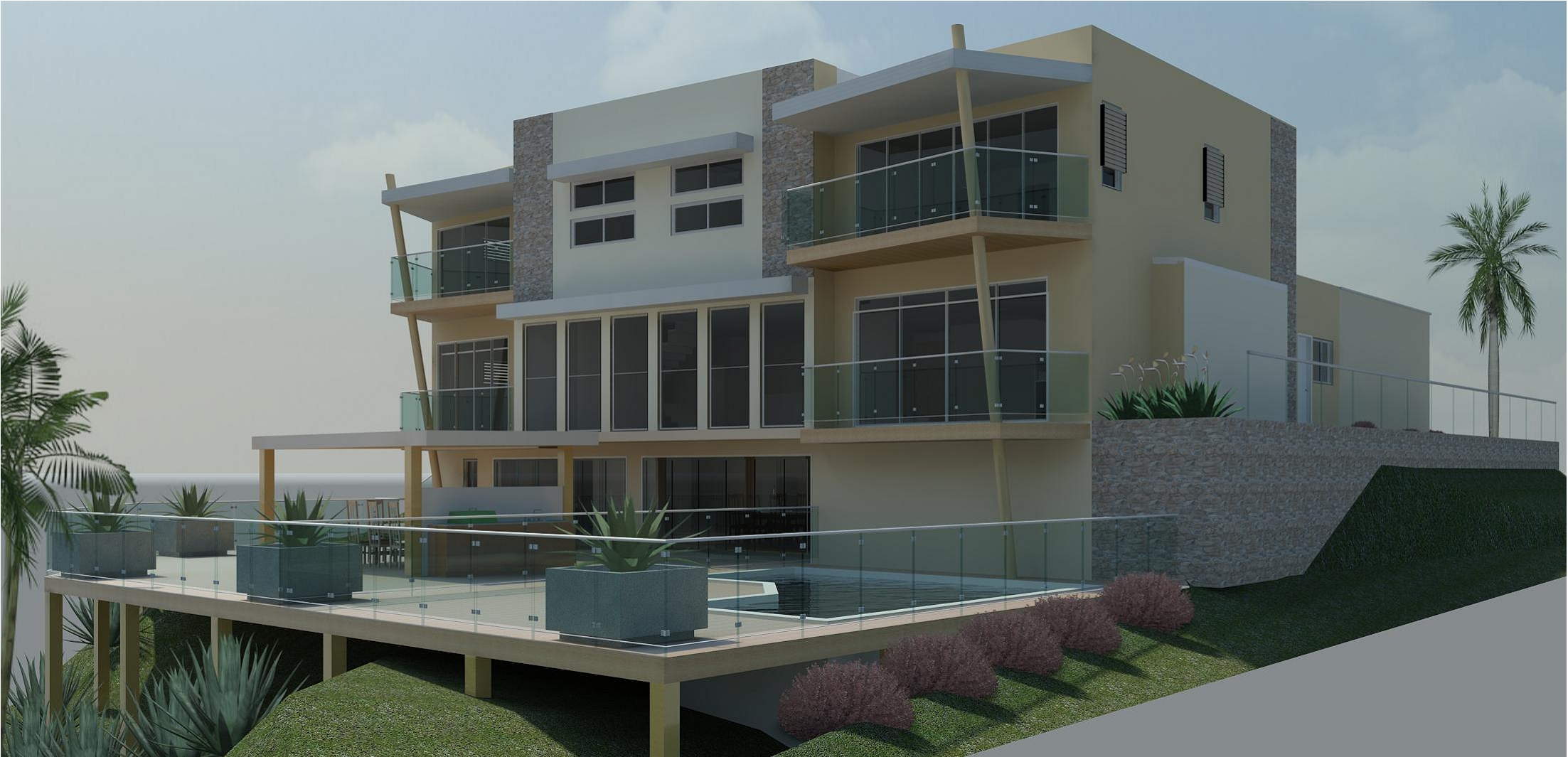

Thanks Chris for reply. Yes it took a while for my boss to decide to make a switch, but main reason was luck of time since we are quite busy office and we had to use some weekends to attend those classes. On a long run, I think it is going to be worthwhile and like anything else, with enough practising, we can 'get there'.So far most of my troubles are related to topography especially in regards to steep sites. I have bought a few books about Revit 2009 and they are quite informative, but not as useful and helpfull as these web site and video clips.
I have attached my first project done in Revit, 3 levels residence, and to be honest I was surprised by the quality of rendering using Revit Arch. 2009. With some photograph in a background could look quite impressive. Speaking  of background additions, can you recommend any site I can download some photos and use it for my projects?

stankovic....is incredible the quality you have reached in few time if this is your first "real" project done in Revit. You should upload that image to the gallery. That desmostrates that switching from an obsolete software (ACAD really is not for architects), to a real architectural software is the future for the companies....congratulations......

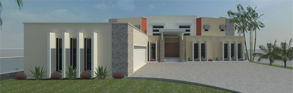

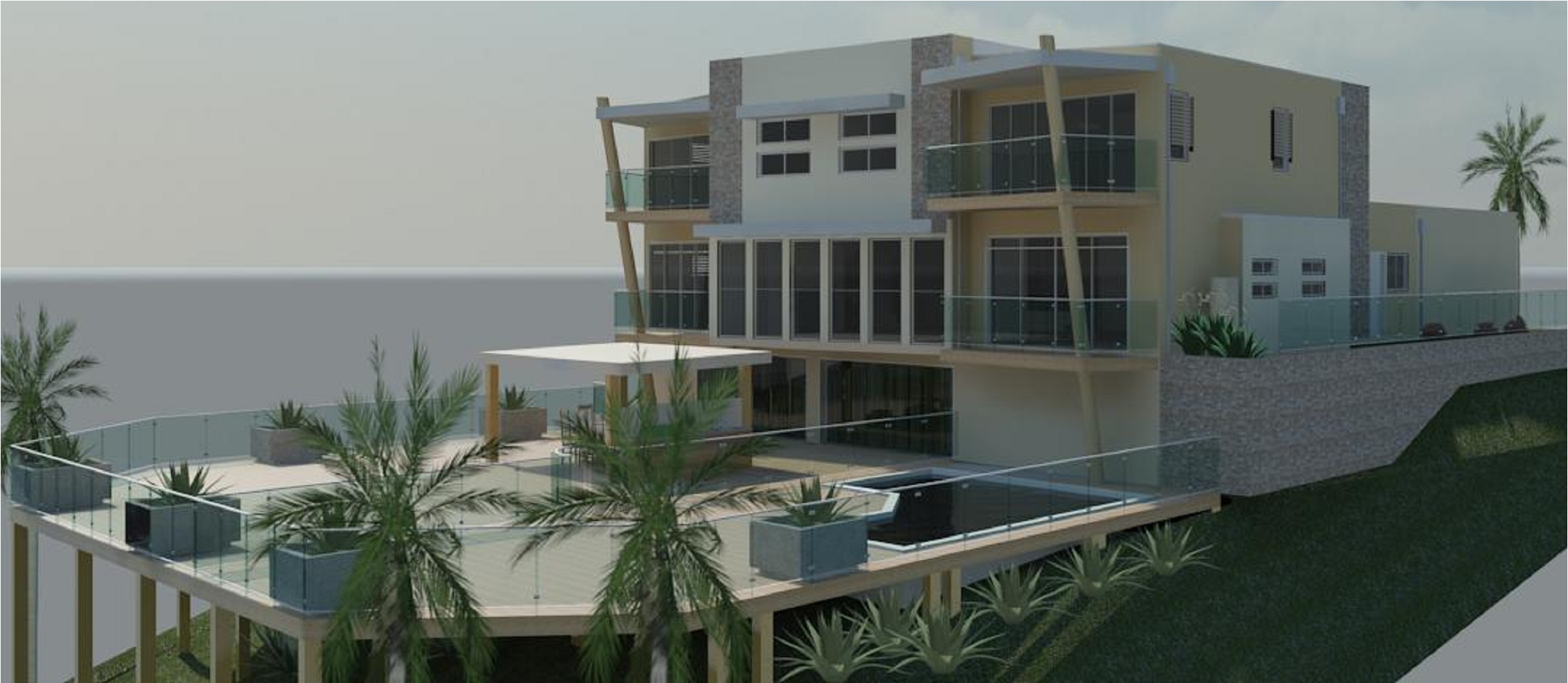

Yes this is my first 'Real' revit project.  Let me tell you, seing the results of my first project, I was excited as a little kid in a toy shop. This was all new for me as I never used 3D modelling before. These are couple more images of same project. I'll upload all images into gallery. I know there is a big battle ahead but this is definitely way to go.
