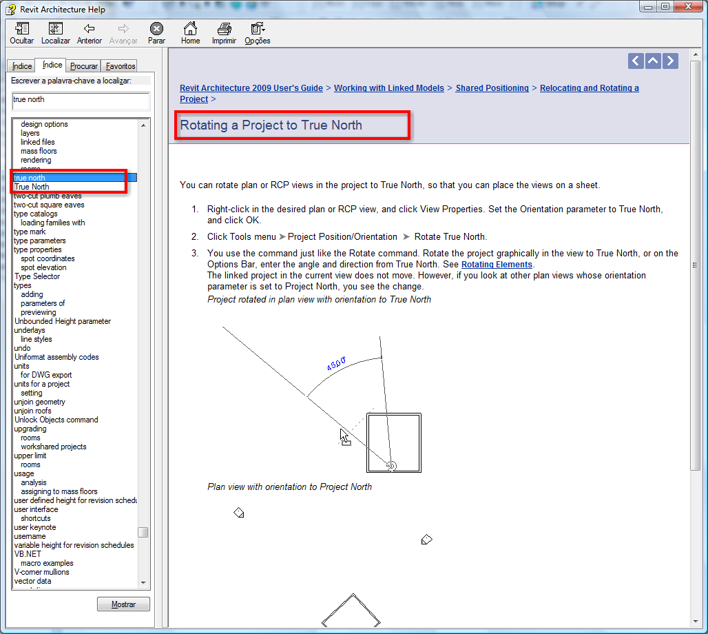

Did you check the HELP menu???

Typhoon, thanks for your assist as well but I think you misunderstood my question.  I am looking for a north arrow family that I can orient at different angles on my sheets depending on which direction is north for my plan, not at how to rotate the plan and create true north with the building plan.

Sorry for that...
