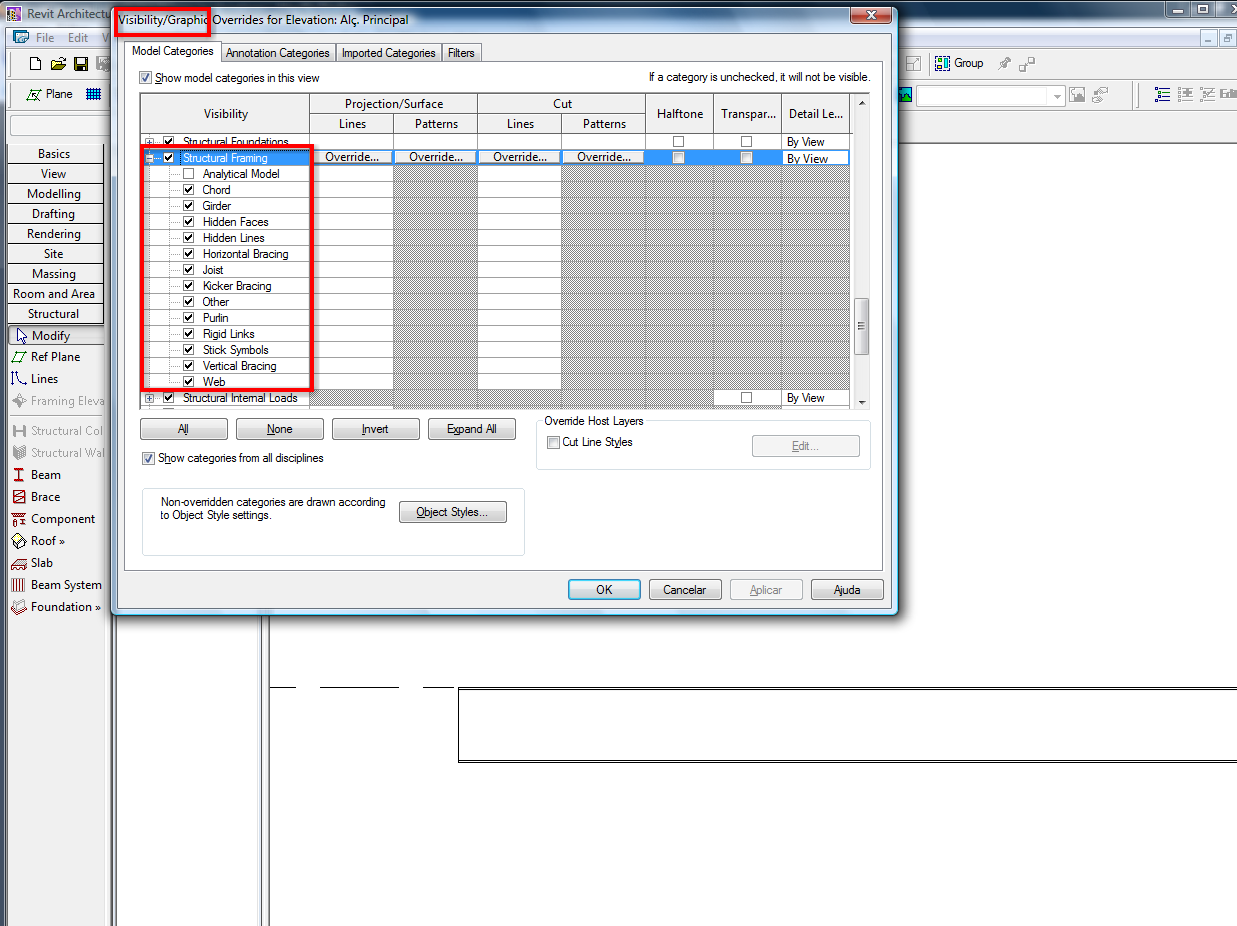

How do I get beams to display correctly in Elevations? I'm getting 1 fat line showing at the center of beam, No beam outline). I can't seam to find any display control in the beam family. Having same issue with 4 x 4 Posts.

Are you in "Coarse or Fine" mode??? in the elevation view go to VG and check "Structural Framing" like you can see in the image attached....

The display was set to coarse. That fixed it. Thank You

Yeah, you can "edit" the family and change the "visibility" to show in Coarse mode...
