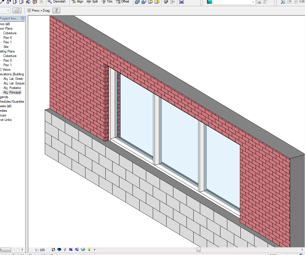

I can't seem to get my stacked wall to wrap where my curtain walls are embedded.
I've tried adjusting the seperate wall types in the stacked wall so that they wrap, however they don't seem to work when a curtain wall is introduced.
Does anyone know why this is happening?

You can always use the "Paint tool" to wrap the wall like you can see in the image attached if this is what do you really want....
