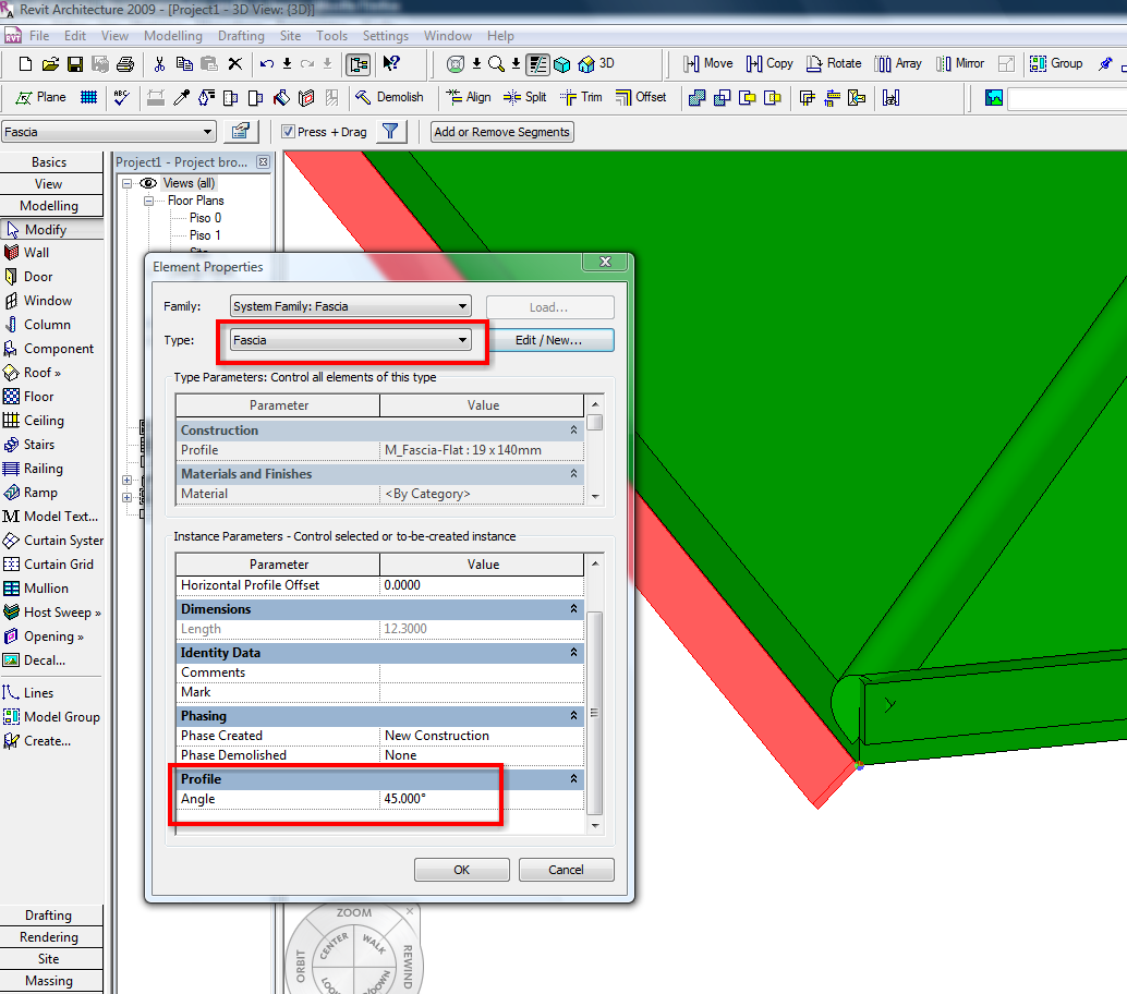

Hi, in the properties you have the option "Angle" like you can see in the image attached....

But it isn’t that angle that I want to be able to change (see attached file)
The angle is in the profile family.

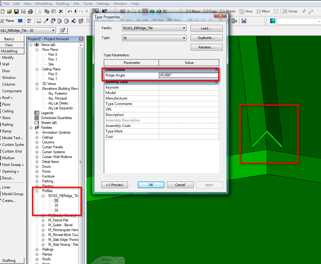

Yeah, you must go to the properties, go to the "Project Browser" Profiles-choose your profile, right button and Properties, there you have your "Ridge Angle" like you can see in the image attached...

Go to the Element Properties and change the profile there.  You will have the different angles that you have set in the family available.
