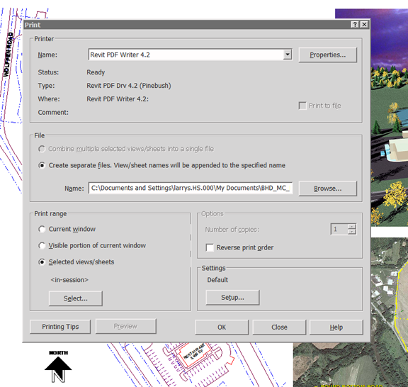

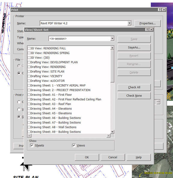

Unless I am not understanding the question, the Revit PDF Writer 4.2 (Pinebush) has this ability. Unfortunately, this was replaced in Revit 8.0 by the Autodesk DWF Writer. Since it was installed with Revit version 7.0 as a system printer, it remains on my computer to this day and I still can enjoy the use of it. I have attached a screen capture of the print dialog box and will follow up with a screen capture of the drop down menu listing all the sheets which can be added. It appears that Autodesk is preparing to take on Adobe in the digital print arena with their DWF Writer.

Screen capture 1 again. Apparently the file size was too large.

Now screen capture 2.

I've never considered the Pinebush PDF writer a valid option due to its super large print margins which generally result in most of our titleblocks being chopped off... But agreed, yes it does have this ability...
