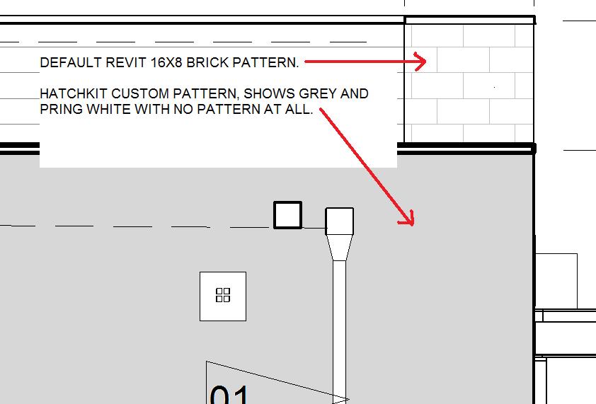

Hello there,
I have made a hatch with Hatchkit that is 16x8 CMU with a sand pattern on top of it.  When I load it into Revit, it's visible, unless I zoom out a ways and then it turns grey.  When I try to print, it just prints a white fill!
I even rememved the sand pattern and it was just CMU and it still doesnt' print.  But it does print Revits default CMU pattern.  Any ideas as to how to fix this?

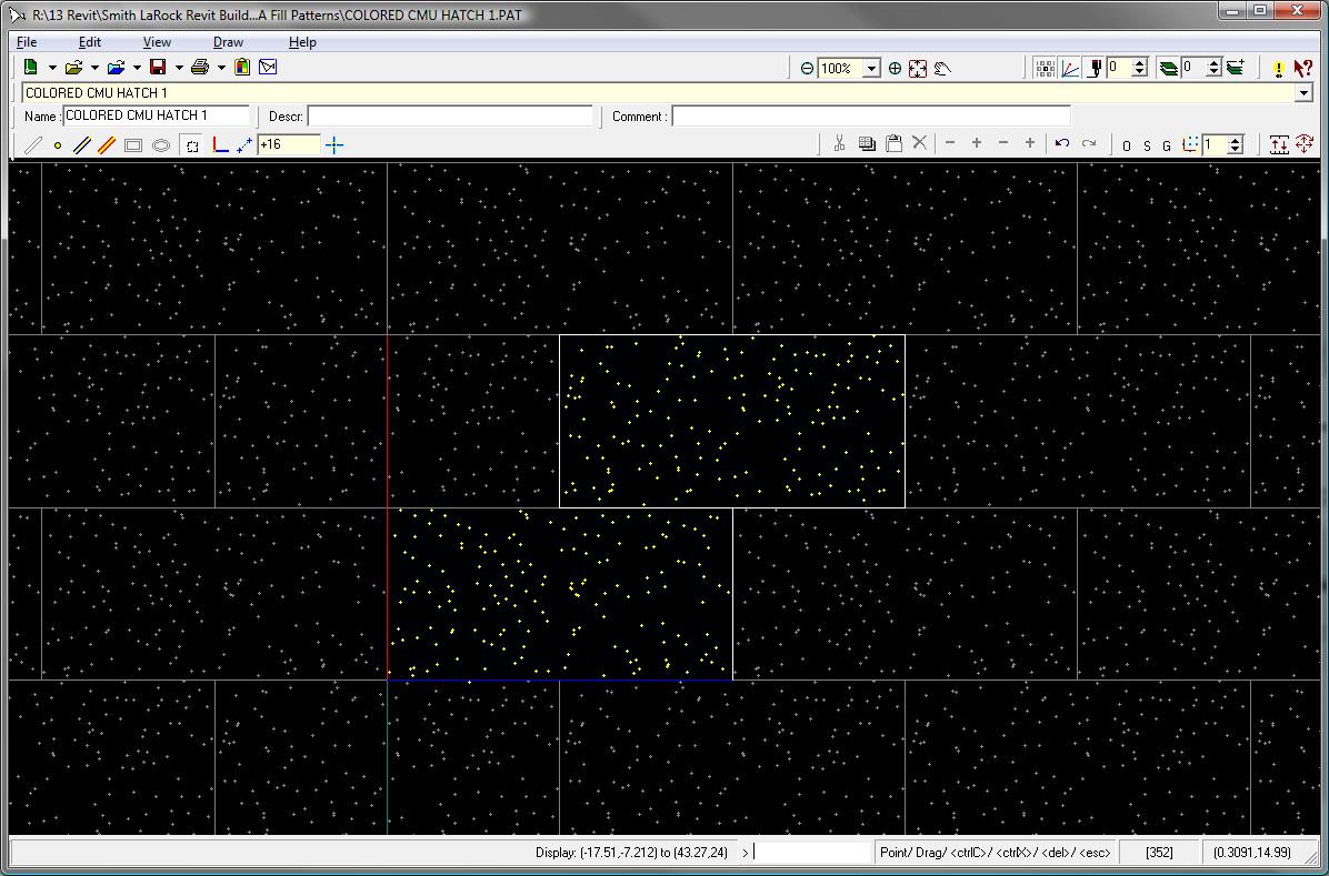

Hello,
I've attached a Revit Screren Shot and Hatchkit.
I am using Revit 2009 64 Bit, Vista 64 Bit, 4GB RAM, quadprocessor.
I don't know why it's not printing.  Can anyone tell me why?  Thanks,

Mon, Dec 22, 2008 at 11:24:39 AM | Revit not Printing custom made Hatch with Hatchkit
lorne ... it may be that the scale of your hatch is so small that you only get a grey pattern.    check your units out
Mon, Dec 22, 2008 at 11:39:32 AM | Revit not Printing custom made Hatch with Hatchkit
lorne17
lorne17 Avatar
Joined: Wed, Aug 29, 2007
417 Posts
3.5 Stars: 7 Votes
No it's correct.  Cuz when I delete the sand hatch and just import the CMU hatch, it is the correct size.  16x8.  But even just that simple hatch doesn't print.  So I know the scale is correct.

Lorne, we welcome all feedback. Please upload the .PAT file or send it to the email address shown on the HatchKit "About HatchKit" panel. Also, what printer driver are you printing through? Vanishing hatches have occurred with some AutoCAD plotter drivers.

Hugh,
Printer driver I'm unsure of, It's an HP LaserJet 5550, Doesn't work on the HP Deskjet 500 either.
I've attached the Hatch.  I sent it in this morning to the email address on the contact us page at your site.

Hi Lorne,
Yes you did and thanks, my bad for not checking my entire intray.
The problem you encountered is that the HatchKit Demonstration Version watermarks the patterns it creates as an inducement to purchase of a licensed version. Obviously any watermark should always be visible to avoid confusion - we need to fix this.
The attached CMU + sand pattern has no watermark.  I hope it helps progress.
