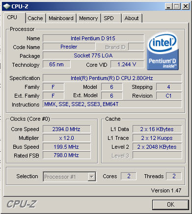

great info. if you wouldnt mind keeping this updated with any future tests/info i would appreciate it. We bought a test 64 bit dell t5400 with xeon quad core and 8 gigs of ram and it is performing brilliantly. for comparison sakes with both machines on a gigabit ethernet the two machines are as follows:
current machines widespread thru office
See attached CPUID log
New Test machine
Both Machines have NVDIA Quadro FX 1700 with 512 Mb RAM video cards pushing a dell 24" widescreen monitor @ 1920 x 1200 resolution
Current machine takes 1:48 to open Revit.exe completely
Test new machine takes 9 seconds
this is just one simple homegrown side by side benchmark. As you can see 64 bit Revit with 8 gigs of RAM is a HUGE upgrade in performance. Which was to be expected given the Pentium D's older outdated architecture.
