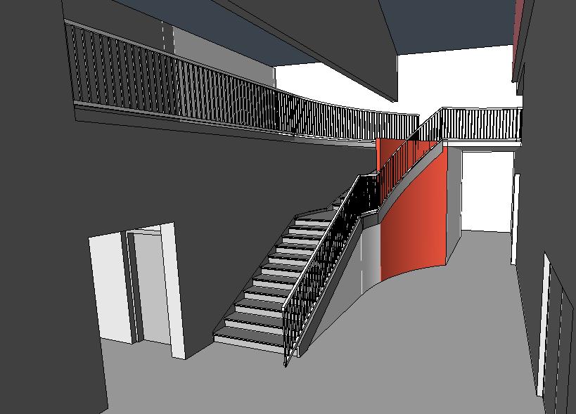

Check out the attached image.  I have a curved stair with a curved wall beneath it.  I need to "slice" the wall at the stringer.  I've tried drawing a reference plane and attaching the wall to that..... but since it is a curved stair, it is very difficult (maybe even impossible for all I know) to draw a reference plane at the correct slope.  I can't do a void sweep because the path is not 2D.  Any other suggestions?

Hi, "I can't do a void sweep because the path is not 2D.  Any other suggestions?" - Well, use the "Void Swept Blend" in a "create in place" "family-Wall"...

Thanks!  That worked!
