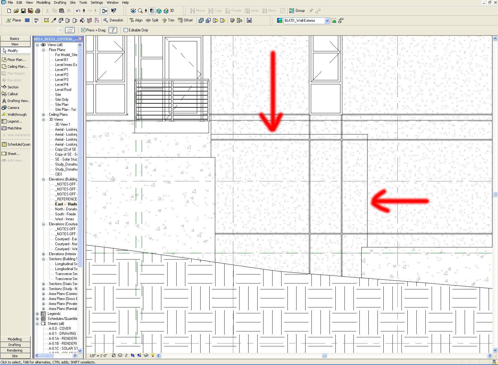

There is a line that revit created between two different wall types in my elevation, as shown in the attached JPEG. One wall is an 8" stucco wall and the other is a 12" concrete wall with the same finish as the 8" stucco. I have tried joining the walls but that didn't work. Any ideas on how to make the wall look smooth, without these lines?

Make sure that your wall surfaces are aligned properly, failing that use the linework tool (top left of your screen beside the match properties & tape measure icons). Set the line work to invisible lines and then select the offending lines

That did it, thanks for the help
