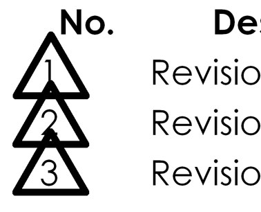

I need a way to increase the the space between rows on my revision schedule without changing the font size. We put triangles over the revision numbers on the schedule and if the triangles are big enough to fit over the number they overlap each other. Is there anyway to correct this?

i know it's been awhile since this thread was posted but I was wondering if anyone had figured out how to adjust the revision schedule row height yet?  I am having the same problem as ChopperDave. i thought we could just check the "blank line" option in the revision schedule of the title block but the option is greyed out.
 any help would be really appreciated!

Some things you need to adapt to what Revit can do.  In our case, we put the triangle around the NO. in the header and just have the text numbers.  Users understand that just as well.
Otherwise, there is no height adjustment except for character size.
