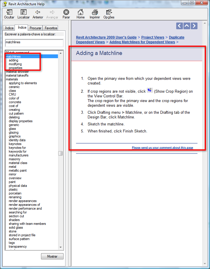

Hey, I'm not in Revit, but I think a match line is where a plan is too big to fit on a sheet so you duplicate as dependent and draw a "Match Line" which symbolises where the plan will be split in order for it to fit onto sheets. You put the left hand side of the match line on one sheet and the right hand side of the match line ges on another sheet.

Timbo is Right, "DEEP" check your HELP menu....

yes i'm wrong
