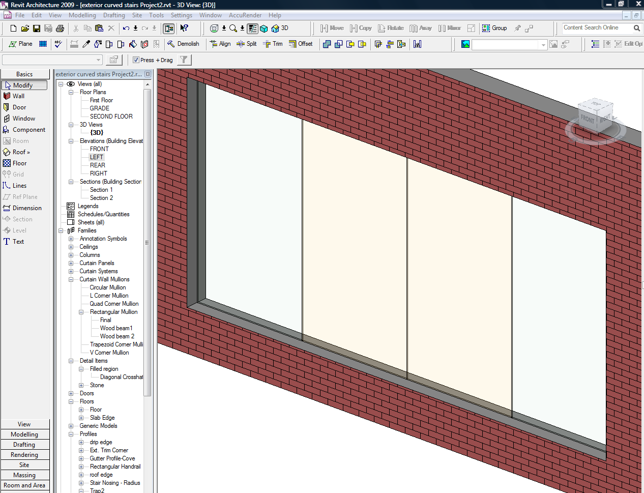

I need to know how to create a glass partiton wall with four horizontal glass panels. the two panels in the middle are a difffernt glass type than the top panel and bottom panel which are a typical glass type.
I cant figure out how to do this. Any suggestions?
Wed, Dec 10, 2008 at 4:27:38 PM | Help with glass partition walls
One possibility - one wall ... then edit face and pour on your material....
Second - stacked wall

I'll try that. I thought that if i created my own curtain grid and then placed my own mullions that it may allow me to edit the sectins individually. not so...

Select the 2 glass of the middle, go to the properties, Edit/New, in the Material pick in the right and select the glass material and duplicate it (give another name), then change the material you want.....

Awesome!!! This worked perfectly!
