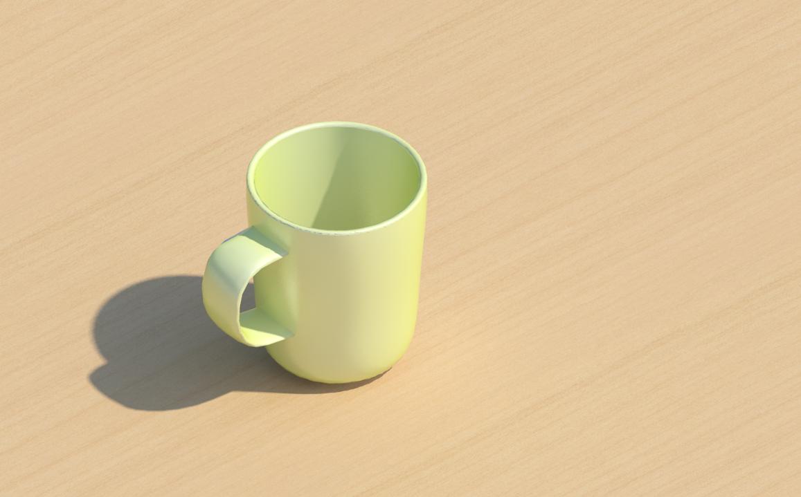

I created a coffee mug as generic model(to scale)... basically i just used a revolve to form the mug and a sweep for the handle.. however.. the mass that i created is dis-formed and edgy(if you look at the yellow mug in the render and in the family..)
Why is it doing this? is the scale to small?

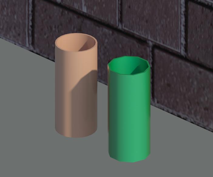

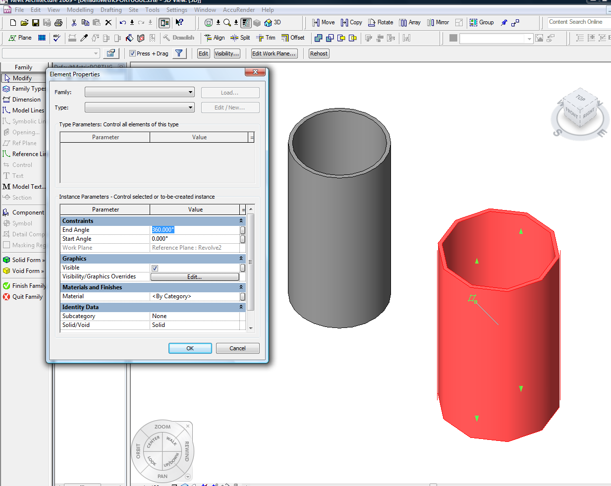

Revit facets small round objects, but it does depend on how they are created - see attched image.  The cylinder on the right was extruded and the one on the left was revolved.  Both have a 50mm diameter.
Wed, Dec 10, 2008 at 7:41:33 AM | Coffee Mug
Joined: Tue, May 22, 2007
5921 Posts
4 Stars: 205 Votes
Yeah, with 2mm on the right is Revolve, and on the Left is Extrusion...
