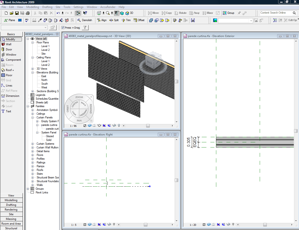

Using RArch 2009
I am setting up exterior wall types for a prpoject. I have a ribbed metal panel wall that I am debating whether to set up with wall sweeps vs. no wall sweeps and then just using a repeating detail in 2D. I am leaning toward the repeating detail. ONe reaosn is because when I set a repearting sweep to denote the ribbed wall exterior, the structure and sub-strate part of the wall are independent of the sweep. Refer to the attached file
Is there a way to have the profile track the height of the wall? Would several instances of a wall with a wall sweep weigh am model down?

Typhoon, thanks for your help. I set up my wall by applying a sweep in the wall editor, like you described first. I would like to have the profile always cover the entire face of the wall. I may have walls of different heights and the height of the profile is always set.
I suppose I could add a parameter linked to a linear array that defines the profile where the top and bottom / begining and end of the array are defined by the top and bottom of the wall. I'm not sure if this is possible.

Hi, you can create a parameter to control the "Lenght" of the profile BUT the problem is you only can control that distance if this is a "Type" parameter and not a "Instance", wish means you change the lenght of that type in the all model, what you can do is after insert the profile in the model is going to the project browser and duplicate the profile, change the lenght of them and assign diferents "Sweeps" to the walls, you you have few different wall, well it's easy, the problem is if you have a LOT of different wall with different sweeps(lenghts)...

Well, don't work because the groups, but you allways have the problem of the fixed distance, in this case, and like you have severals "Heights" of walls i use "Curtain Walls", see the image attached...

What i try to say is USE Curtain Walls....
