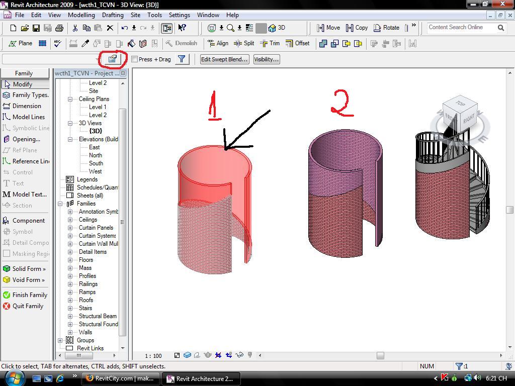

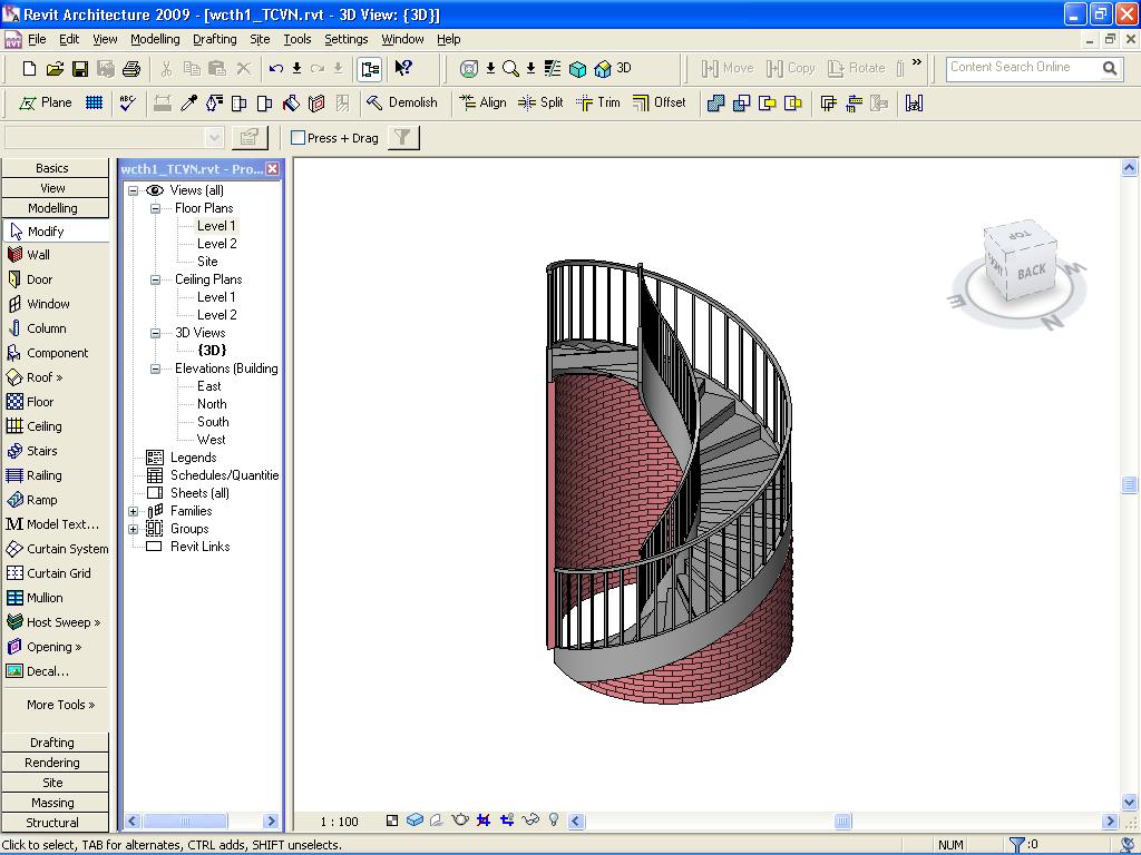

I want draw a wall under arc stair .
Fri, Dec 5, 2008 at 7:07:32 AM | make arc wall under stair
Joined: Tue, May 22, 2007
5921 Posts
4 Stars: 205 Votes

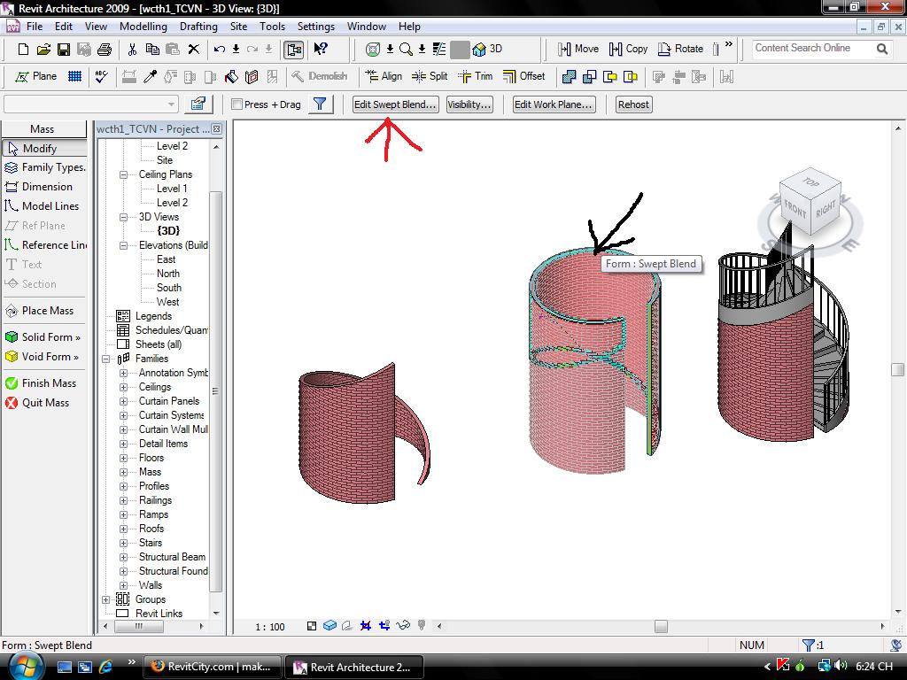

I don't get it, by Your images you just create a wall under the stairs using the "Swept Blend", are you talking about the category of the wall? when you create a in-place you can choose the category for your elements but if you choose at the begining a "Generic Model" you can change that if you edit the "Object-swept blend" and in Settings-Family category and parameters and change to "Wall".... if this is what do you want...
Fri, Dec 5, 2008 at 7:22:33 AM | make arc wall under stair
trandung
Joined: Mon, Jun 9, 2008
72 Posts
number 1 : sample wall
number 2 : My wall
I like my wall same number 1.

OK, so create a "VOID SWEPT BLEND" to remove that portion of wall....

Fri, Dec 5, 2008 at 9:39:13 AM | make arc wall under stair
#11
rkitect
rkitect Avatar
Joined: Thu, Dec 16, 2004
792 Posts
4 Stars: 29 Votes
Ah.. Wait.. I think I see what you are saying.  Your Void Swept Blend is not cutting your wall.  Is this correct?

Fri, Dec 5, 2008 at 9:47:09 AM | make arc wall under stair
#12
trandung
72 Posts
Oh yes. My friend send for me one file . It has a wall under arc stair. I try draw same but can not do that.? Thanks youEdited on: Fri, Dec 5, 2008 at 9:49:12 AM

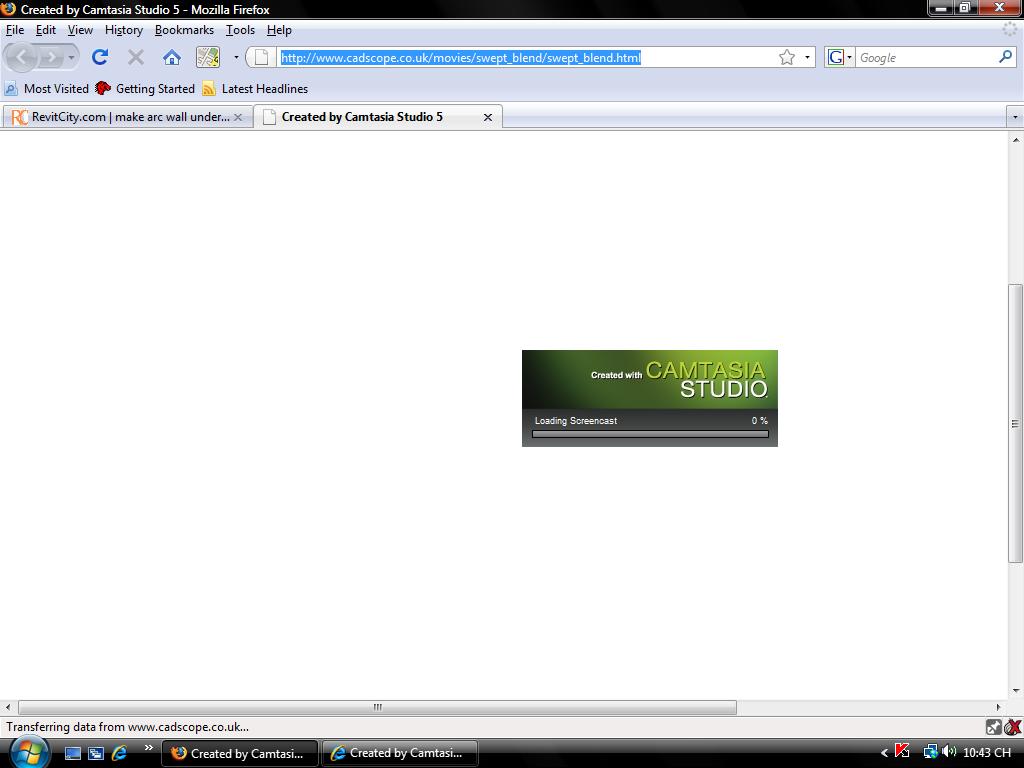

Fri, Dec 5, 2008 at 10:25:37 AM | make arc wall under stair
#13
5921 Posts
4 Stars: 205 Votes
Yeah, the video is there, pick here: http://www.cadscope.co.uk/movies/swept_blend/swept_blend.html

Fri, Dec 5, 2008 at 11:03:14 AM | make arc wall under stair
#15
rkitect
rkitect Avatar
792 Posts
4 Stars: 29 Votes
My guess is that you can not see the video because you do not have the latest version of flash installed.  This means you probably won't be able to see this video either, but you can give it a shot:
http://gibsonhh.info/revit/video/slopedCurveWall_2009.swf
