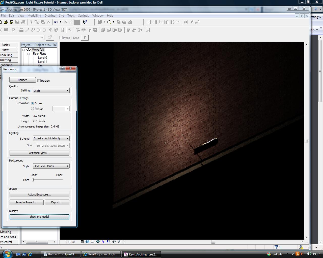

I need to render the lights in the attached file but I cannot get the light to shine through the fixture. Can you help?Edited on: Thu, Dec 4, 2008 at 4:43:43 PMEdited on: Thu, Dec 4, 2008 at 4:44:32 PMEdited on: Thu, Dec 4, 2008 at 4:54:22 PM

I have opened your file and loaded into a project - it seems to render OK unless you are expecting the light to shine the other way.  See attached image.
Opaque light fixture not emitting light
