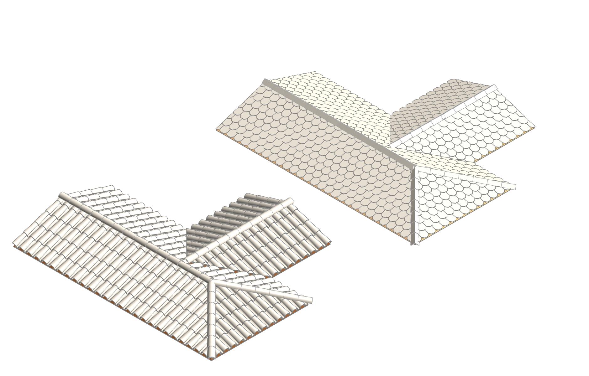

HOW CAN I SHOW HIP TILES AND EAVE TILES IN MY PROJECT.  I HAVE TRIED BUT NO SUCCES. I'VE SEEN TYPHOON PICTURES AND THAT IS WHAT I LIKE TO SEE IN MY PROJECTS.

I HAVE ATTACH A COPY TO LET YOU SEE WHAT I WANT, HIP, RIDGE, EAVE TILES AND MORE REALISTICS

HI, why don't you ask me directly, i am in the site, if you want to know how i did it YOU CAN ASK, ok?
Those are the families i attach so you can do that, i just (one hour ago) delete several videos to explain how to do this, first you insert "BEIRADO-CANTO" in the corners at the right height, then insert (load component) "BEIRADO-TELHA" - it's a generic face based, in the end of roof, at the wall, whatever, this have a parameter (comprimento) "Lenght" to adjust....

Hip, ridge, eave... and rake tiles available. Contact me for more info. If interested I have a sample file.
